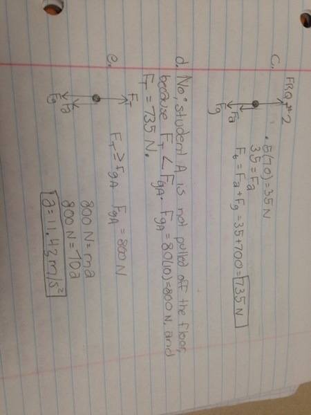

I solved in other problems related to this that the normal force exerted by the floor on student A is 100 N, and I tried to do part A (I will post pictures in a minute). Part B and C I am very unsure of, and I do not know where exactly to begin with these parts. If I could have any/all hints at a direction for part B and C, that would be greatly appreciated 8D.
Pictures coming in a reply.

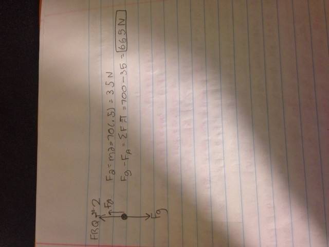

this is my attempt at part A and below is my image
so, acording to your calculations, there is less tension on the rope when student b is acelerating upward than when he is just hanging on? does that make sense to you?
Imagine you are student A, do you think it would be harder to hold on to the rope when he is just hanging there or when he is climbing?
sure he is acelerating upward, what about the rope? is it acelerating upward with him?
Likes komarxian
! Since he is climbing the force he is applying will be in the opposite direction of his motion, and that will make tension larger?
yes, the rope besides "feeling" his weight it would also "feel" the force he is applying to manage to climb it, his weight applies a downward force (on the rope) and so does the climbing
that should help you out for b and c.

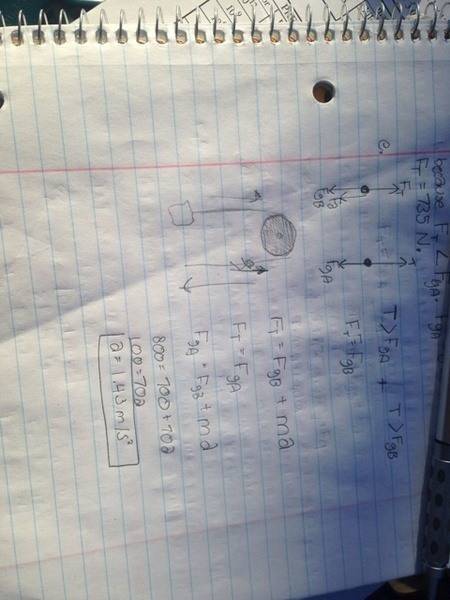

This is my solution for part C. Is it correct?
yeah, you see, your previous answer was 11.43, because he (student B) needed to "make" the rope accelerate at that speed, what you forgot was that gravity was allready making it accelerate at 10 m/s^2, so he only needed that 1.43.
and don't forget if Ft is exactly 800N the net force will be 0 (on student A) and basically student A will no longer "feel" is own weight, but won't be enough to lift him.
anyway funny stuff; since tension is 800.1N for that acceleration (1.43), student A would accelerate 0.00125 m/s^2.. which means it would take 40 seconds for him to rise one meter :). .. on the other side of the rope, student B would have climbed 1144 meters in those 40 secs :D
