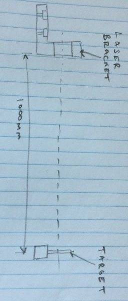

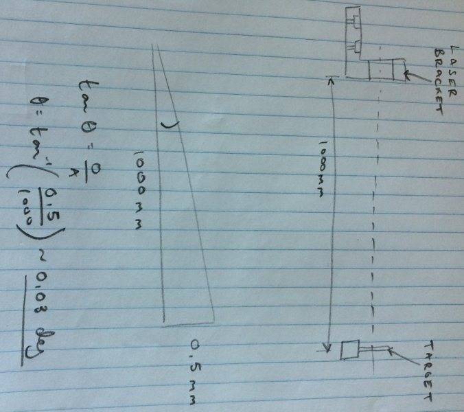

Okay next drawing. Please see sketch 01. Let's say that I want to clamp a laser pointer in a bracket and have the beam hit a target which is exactly one metre away. The maximum deviation that I am willing to permit the beam to have with respect to dead centre of the target is 0.5mm. So over a 1000mm I only want a pointing error of half a millimeter, see sketch 02. This equates to approximately 0.03 degrees. I want to tolerance my drawing with GD&T in such a way that the manufactured part achieves this accuracy.
I have attached the drawing (bracket.pdf), please tear it to pieces. Assume that the centre of the target is 47.5mm from the mounting surface which is also perfectly flat.

Been there done this. Martin Hamar pioneered machine tool laser alignment about 30 years ago. He started with a laser beam and ended up with a three plane laser scanner that projected 3 laser planes precisely perpendicular to each other.
A single laser beam does not tell you much. You must make it steerable so the projection is perfect to the mounting surface. Precise machining is costly. The photo electric cell or target will give you an X-Y displacement from the center point but not much else. Martin split the beam when it entered the target and could read center and angularity. This is very useful in alignment of a machine tool spindle as the tool path when drilling is very important to tool life. Beams take a long time to “buck in” or align to the machine guide way so the use of a laser plane makes the set up time very short. The squareness of the laser planes was very useful in checking the 21 errors in geometry of a machine tool ( less scale calibration) .
suggest you visit hamar laser web site

Hi Ranger Mike,
Thanks for the reply. I'm not actually going to have this bracket manufactured, the purpose of the drawing is simply for me to develop my understanding of GD&T. I'm trying to choose simple examples, I realize now that the laser bracket is perhaps not as simple as I first thought.
Do you have any comments on the GD&T I've applied to the drawing?

I see some practical problems with actually using this design for its stated purpose. Since you are asking about diminsioning standards rather than mechanical design, I will leave it to those with better familiarity with dimensioning to continue the discussion here. I will continue to watch this thread, however, in case there is anything substantive I can contribute.

Now that is a problem (in post #4 above) that is underconstrained! Is the Laser beam required to be perpendicular to the target? Since only the linear dimensions are given, the Laser could be positioned anywhere on a 1-meter radius hemisphere and aimed at the target.
Just to simplify things, let's assume that perpendicularity is required and the target is appropriately fixed to a beam or bed on which the Laser is also mounted.
Here are some things to consider in mounting the Laser:
  1. Keep in mind that you do not have control over the how the Laser diode is aligned within its package. How will you handle this?
  2. What is the reference surface for Laser aiming?
  3. The four mounting holes in the bracket seem to be sized for clearance of a M6x1 machine screw and 'preferred' tolerance. Be aware that the mounting screws have both a diameter tolerance and a builtin clearance allowance. Thus both the exact position and angular rotation of the bracket on its mounting surface is uncontrolled.
These are things that must be either controlled or compensated for at assembly or calibration time. There may be more.

1. Without being able to adjust the pointing of the laser bracket, I would initially quantify the pointing error of the laser with respect to the package: this error would then need to be accounted for in the positional requirement which would of course flow down to the manufacturing tolerances. However, in real life I would just mount the diode on a two-axis adjustable mount.
2. I was just going to use a hypothetical bulls-eye.
3. Yes correct on the M6x1 clearance holes. With respect to controlling angle and position, I would likely use three dowel pins to act as reference surfaces.
