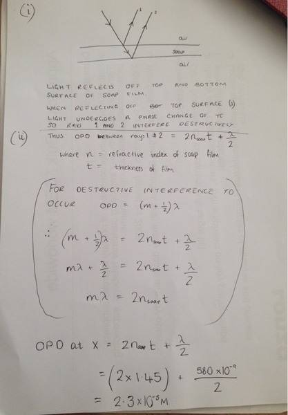

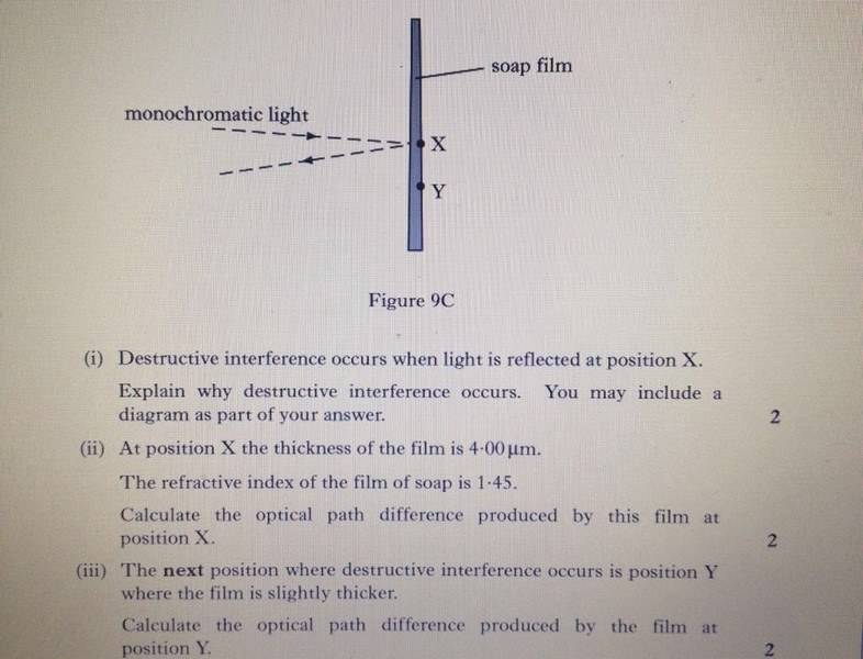

Could someone please explain this question to me I'll include what I thought the answer was and the actual SQA answers.
Please can you read my answer just to see what I'm doing wrong and what I don't understand
It's from the 2009 past paper AH physics

1. Homework Statement
these are gien below in my attampt and in the SQA marking scheme included below

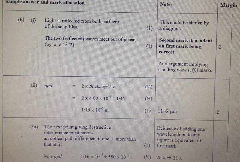

this is the answer given by sqa

Your 2 n t looks more like 4 n t and what you write down doesn't correspond to what you calculate.
Furthermore, you and sqa both seem to know ##\lambda##. We don't.
So: work a little less hasty, and you'll be just fine. Good luck tomorrow !

sorry λ is 580nm
thanks so much for ur reply
