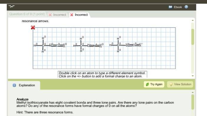

I need to write the lewis dot structure along with the 3 resonance forms for CH3CNS. This is what I had but it was wrong. Not sure what to do. Thanks.
woops, sorry didnt know it was going to be huge.
Resonance forms do not involve the movement of nuclei, so 2 and 3 are wrong. Actually, 3 is a different compound altogether. Perhaps consider pushing the lone pairs on the sulfur and nitrogen on structure 1
