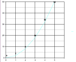

You observe a gooey object falling from a 55 meter high tower (a big turkey nests on the tower) toward a hapless old woman feeding the pigeons from a park bench at the base of the tower. The tower has meter marks on it and you record the time of the falling object as it falls. You make the following data table.
Time (s) Distance (m)
0 0
1 2
2 8
3 18
4 32
5 50

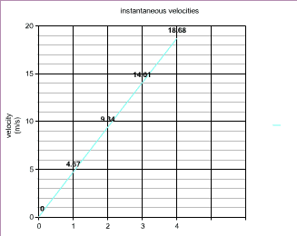

Plot this data - like you know how to (graph above). Find the instantaneous velocity of the object at the time of 0 seconds, 1 second, and 4 seconds. (below this paragraph) Plot the instantaneous velocities on a new graph. Calculate acceleration. Plot acceleration on a new graph. Determine a general formula for velocity. Determine a general formula for distance.
These are the numbers I got for instantaneous velocity.
0 seconds = 0 m/s
1 second = 4.67 m/s
4 seconds = 14 m/s
They seem a bit off, but I guess they're okay.
I don't understand how to plot the instantaneous velocities. I got something like this:
It's wrong though huh?
Acceleration out of nowhere I got 7.5 m/s^2
For my V average formula, I got v = at
for my d formula, I got d = 1/2 at^2

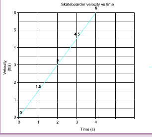

Your friend skateboards straight down Twin Pillar Way. Your friend is wealthy and has a speedometer. He records this graph above. Using the graph, determine acceleration, plot the acceleration, determine an equation for velocity, and determine an equation for distance.
For acceleration, I got 1.5 ft/s^2 and I plotted it. If that's wrong I may as well jump off my roof now.
The determining equations part is eluding me. Also, are formulas the same things as equations? <_<Number 3:

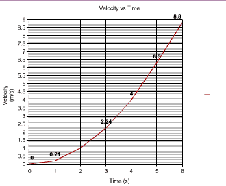

A rocket is launched and its velocity is measured at over 6 one-second time intervals. What are the instantaneous accelerations at t = 0, t = 2 seconds, and t = 4 seconds? Plot the acceleration vs time. What is the rate of change of acceleration? Determine a general formula for the acceleration. Don't forget to include proper units.
Here are my instantaneous accelerations
T = 0: 0 m/s^2
T = 2: 1 1/10 m/s^2
T = 4: 6 m/s^2
Here's my acceleration vs time graph, which is horribly deformed.
What's wrong with it?
This also makes finding the rate of change of acceleration an abnormal task, as well as finding a general formula for acceleration D:

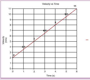

You had to resort to passing an elderly Sunday Driver while you were riding your bicycle. What was your acceleration over the 6 seconds? Plot acceleration. What is your overall distance you traveled during your passing the Sunday Driver (over 6 seconds)? Determine a velocity over time equation. Determine a distance over time equation.
Acceleration is 1 1/2 m/s^2...hopefully?
Acceleration is easy to plot, thank god.
I said that the overall distance he traveled was 9 feet...right?
My mind exploded when I had to determine more equations, so those I didn't do @_@

Your #1 looks pretty good! You don't say how you are getting the velocities. Are you finding the slopes of tangents on the distance graph?
The acceleration will be the slope on the velocity graph - easy because it is a straight line: a = rise/run = 18.7/4 = 4.7
For #2, your acceleration is correct! To get the equation for velocity you could just remember the formula: V = Vi + at = 0 + 1.5*t.
Or you could recall that the velocity is the area under the acceleration graph. That graph is a rectangle because the acceleration is constant at 1.5 for all times. Thus the area up to time t would be
A = L*W = 1.5*t.
In #3, your accelerations don't seem to be right. I'm imagining a tangent line at time 4 and it is going from about 2 m/s to 6 m/s in 2 seconds from time 3 to 5, which would give a slope (acceleration) of
slope = rise/run = (6-2)/(5-3) = 2 m/s^2. The acceleration graph should work out to be a straight line.
#4 - acceleration is correct! The distance is not. Using the method where distance is the area under the velocity graph, you get a trapezoid with average height (2 + 11)/ 2 = 6.5 and width 6. That is an area of 6.5*6 = 39. Using the formula d = Vi*t + .5*a*t^2
= 2*6 + .5*1.5*6^2 = 12 + 27 = 39.

Yes, I found the velocities by looking at the slopes of the tangents.

Good luck, Obelix. There aren't all that many techniques going on here:
acceleration
velocity
distance
Have to find the slope on the graph to go up on the chart.
Find the area under the graph to go down on the chart.
If you don't know how to draw the tangent line, get some help.
