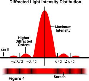

What do you mean by "using different minimums"?, thank you for the answer! very helpful:)
They usually use the first minimum width when making the calculation. However the formula allows for 2nd, 3rd ... minimums to be used. The minimums are the dark bands as counted from the center of the beam on the wall with the first minimum being the closest dark band to the right and left of the center.
Here's a diagram showing minimums and a diffraction image:
