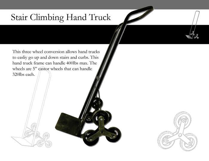

Hello,
So I am in the process of designing a stair climbing electric handcart/dolley capable of lifting around 500 lbs {Washer/dryer or Refridgerator} up stairs. The idea was to use an electric motor, preferably DC for HighTorque Low Speed and for my powering options. The idea was to use the 3-wheel stair climbing system already in existence, but to put a sprocket on a solid axle, and use a chain hooked to an electric motor to turn the 3-wheel system therefore, climbing stairs. Even better if I could use reverse on the motor to control descent as well. The class I am in is Intro to Engineering Design, and no attention has been put toward any physics calcs so Everything I am learning for this project has been from google.
If anyone could help Steer me in the right direction It would be a big help. I am fresh out of the Army so I have forgotten a lot of the technical info from HS days, and being a Combat Engineer(SAPPER) doesn't help me with this. If the cart needed blown up, Icould do that no problem! lol If anyone out there could provide me with good websites to help break down some of these torque calculations, and any tips about what else to include in my design calculations so hopefully my first shot at prototype is close to success, all would be greatly appreciated. If someone has a good idea for a type of electric motor worth using on this project, also would be a help. I am leaning toward a winch motor from an ATV hoping it can handle a 300-500lb capacity without burning it out. Once again, this is for a school project, my first engineering class which seems to emphasize more on AutoCAD rather than Physics. Thank you all in advance!

Can you post some pictures of existing 3-wheeled stair climbing apparatus? Especially ones that can handle that amount of weight...
BTW, since this is for a school project, the thread may get moved to our "Homework Help" schoolwork forums. We can offer hints and suggestions on your project, but we are not allowed to do the calculations for you.

Absolutely understandable. I do not wish for the calcs to be done for me, because how could I learn them for future projects unless I do them. I only ask to be pointed or given the specific calculation/formula that I must figure out in order to get the desired answer or outcome I need.. Thank you for your help.
This is the 3-wheeled stair climber cart that I have seen, but is probably rated for about 50 lbs max. My hopes is to completely beef up the basic idea with bearings, solid axles and machined aluminum/steel mounting brackets so that the wheels and axle can support the weight at standstill and also the torque of the chain/belt system pulling on it.
I have a hard time understanding wjat size motor I will need to use in order to lug this weight up steps. My understanding is a DC motor is ptobably best option, and to add a Capacitor or maybe convert a small 12v rechargeable battery to the cart to power it without an ext. Cord. Odds are I would only need the motor/cart to run at full speed for under 15 minutes [time it takes to power up maybe 20-40 steps/maybe 2 flights or stories]

That's a good start. When I do a Google Images search on powered three wheel stair climber, I get lots of good hits. Including one that I think is probably the most practical way for you to design your project. Maybe try that Google Images search and spend some time looking over the options of what has been done up to now, and see if you see the one that I think is a particularly good solution. Think about the issues with climbing various types and sizes of stairs as you look at the options... :smile:

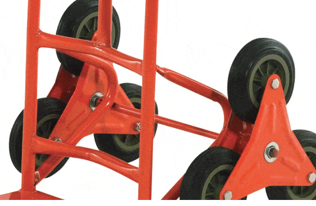

On this setup, each of the 3 wheels rotate independantly of the others, which allows good mobility and turning radius. my plan was to use a straight solid axle with a sprocket or something, linkking the two sides together on one axle and then running a chain or belt to an electric motor. This wheel setup is rated for 400 @ the frames capacity, and each wheel is 320lb cap. for a total of 640 x 2?(2 of the three wheels would be contacting the surface at a time, third wheel would be in mid rotation, for a total of 4 wheels contacting the surface at any given tiime.
With the actual wheels independant of the mounting bracket and the axle itself, this plan would still allow human power to move the cart and weight on flat surfaces without imput from the motor. Essentially, the motor is only there to rotate an axle, which rotates the mounting brackets for the wheels, alloowing it to climb stairs.
Ineed the formulas that sould tell me how much torque the motor and axl will encounter under load (climbing stairs) and the formula that shows me what size motor to purchase for my teams project. I've read that around 5 HP should be plenty sufficient, but no math to support that claim. I understand no calc will be done for me and that is fine. I just would like to know how to choose the right motor basid off of formulas that currently I do not know. Thank you for your help!

There are some important limitations on the simple 3-wheel design in terms of powering it to climb stairs. What happens when the rise and run of the stairs change? In the Google Images, the design that I found that is based on the 3-wheel design had an important other feature that made it much more practical for climbing variable size stairs...

Yes, the load needs to be tilted way back while climbing stairs. You can see this on the videos of the better stair climbing hand-carts with loads like washers and refrigerators...
do you have a link to the cart you were talking about? I was thinking instead of a triangle shaped mounting bracket, I was thinking more of a Peace Sign like a Mercedes symbol w/o the ring & With the wheels on theends, so the bracket wouldn't catch the edge of the stairs. The wheel design is still up in the air, but figured if there was already a stair climber, just improve it with a motor. There is the possibility of using something along the lines of a paddlewheel like a steamboat uses,but to climb stairs. I fear the resistance on the paddles would be too high and might break off.
It seems that the wheels would need to be fixed and non-rotating, to do a powered handcart. Right? Freewheeling works great when the force is applied on the handle. So maybe the three wheel units become something like a three lobed, solid shape?

Well I have the design autocad ed out, now I just need help with understanding the calculations/formulas so I can figure out what motor will power my system/handcart. Perfect world would be a DC motor, with 2 output shafts, that's capable of lifting around 400lbs,[ my max weight cap is 250lb] do you think a winch motor would work if I stuck with a single shaft? For example, remove the spool and input a sprocket and chain instead? Winch motor capable of 800lb likr an atv winch or something of that nature?
You first need to define the required specs; how fast you need to climb stairs.
Climbing stairs increases the potential energy of the cart. E = mgh
The rate of change of energy is power:
P = E / t
So required power is determined by the cart mass and change in vertical height per second.
Once you decide on wheel diameter then you have output power and output rpm, you can work back and spec a motor.
Note that you'll also need some failsafe mechanism to stop the cart free wheeling down the stairs - that could cause a fatal accident.
