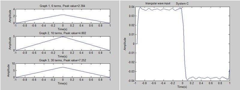

"subplot(311)" --you probably meant subplot(3,1,1) for the first plot, assuming you are planning to display 3 plots on 1 figure.
I just copied a part of the code, the reason i used subplot(311) was to have a plot each for when there are 6, 10 and 30 n terms.
I'm not sure what the signal that i got is called. I've never seen that type of signal before.
The Ts=0.001 related to a previous question i got it muddled up. T should = 1 for y.
Can you attach your result?
I've uploaded the figure with 3 plots each representing 6, 10 and 30 n terms. and System C with the signal.
Neat! --looks like you have a differentiator on you hands!
Why are your amplitudes changing on your plots of the 3 triangle waves? They should be more or less the same amplitude. Hint: re-run everything starting at 30, 10 and lastly 6.
I re-ran everything but it doesn't seem to be having any effect.
Are you saying that on your new run, 30 gives the smallest amplitude and 6 gives the largest?
Yes. Strange
I remember you said in an earlier post that there was not much difference between 10 and 30. Are you clearing out vector s between each run? If you are not, try doing s=0 before each loop. If you are still having trouble, post your complete m-file.
I didn't look at the actual amplitude values before, only the position of the peak of the waves.
I've posted the m-file

That file you attached did not have the statement "s=0" before the 2nd and 3rd n-loop. Please add it (before or after the maxTerms=...).
Looks like you hardcoded the peak value in the title. There are ways to do it dynamically, but if the amplitudes are all going to be pretty much the same, it will add little value.
Also, one final thing: what is the purpose of doing:
% Make wave start at 0
s = s - s(1);
This introduces an artificial offset to the data. Is this required?

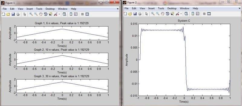

  • #31
s = s - s(1);
It's not really required. I re-ran is by doing s=0; before all the maxterms and i did get a similar amplitude range for all 3 plots. The peaks don't vary much. The question asks us to provide the peak value hence the reason for hard coding it. Is there a simple bit of code that could automatically provide it?
  • #32
Try:
m = max(s)
title_string = sprintf('maximum is: %f',m)
title(title_string)
As for your offset-- then don't do it. It is affecting the peak value you are reporting.
  • #33
I guess the peak value is the same for all 3 plots. The only noticeable difference is the sharpening of the edge of the triangle. I assume as convergence occurs there will be less visible change.

They should not be the same. They should be close, but N=30 should give you a larger peak than N=6. Just considering the summation at the t=0, cos(0)=1, point.
  • #35
Ah it was because i didn't put m=max(s) before every maxterm. I have did that now and got a larger peak. 1.192, 1.209 and 1.225
