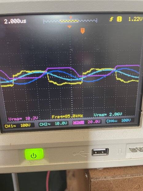

Grounding issues are causing distortion in the oscilloscope tracings of an induction heater circuit. The discussion highlights how different grounding configurations affect the clarity of the inverter voltage signal, with some setups yielding cleaner results than others. The importance of differentiating between signal and power grounds is emphasized, as improper connections can introduce noise and artifacts. Suggestions for improving circuit design include using a parallel resonant tank and ensuring proper clamping diode connections for better signal symmetry. Overall, achieving stable and clean waveforms requires careful attention to grounding and circuit layout.
imsmooth
154

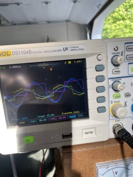

I am having some issues when viewing tracings of my induction heater tank. It has to do with the grounding. First, I will explain the situation; then, I will ask the question.
The images show the inverter voltage in yellow which results in a current in light blue. The dark blue is the 90 deg lagging tank capacitor voltage. The magenta is the tank capacitor voltage after it goes through a series 100k resistor that connects to two diode clamps connected to a 15v and 0v rail.
The power supply has a 15v and -15v rail and a center tap on the transformer for the ground/0v.
It uses a step down transformer with a center tap and goes through a bride rectifier. The output goes to a 15v and -15v regulators.
All images have:
a differential probe connected to the inverter voltage at x500 (yellow)
a standard x10 probe and its ground lead connected to the + and - ends of a current transformer (light blue)
a differential probe x500 connected to the tank capacitor (light blue)
This last part is the variable that I have a question with...

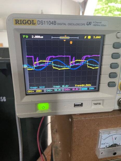

On image 1 there is a standard x10 probe with the signal input connected to the output of the diode clamp and the ground clip connected to the 0v rail. You can see how the yellow inverter voltage is not clean.
On image 2 I have connected an earth ground to the 0v rail. The probe's ground clip is now connected to the 0v rail and earth ground. Although the yellow tracing is not clean, it is better than the first image.

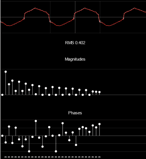

On image 3 I have disconnected the x10 probes ground clip from the 0v rail. Only the signal input is connected to the diode clamps. You can see the tracing is much cleaner.
These are grounding issues. How am I able to measure the magenta tracing in image three if I don't have the probe's ground lead connected to anything? My 0v rail is relative to the 15v rail. It is not necessarily at the same potential as earth ground. Are my signals in image 1 and 2 really not "clean" or is this an artifact from how I am not grounded properly? Why is my yellow tracing using a differential probe affected by my measurements with one of the standard probes?

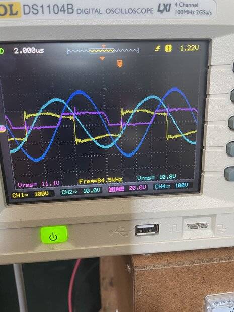

I think I got it to work correctly using a different circuit design. Still have some distortion on the yellow inverter tracing by having one end of the high voltage capacitor connected to the ground lead of the circuit board.

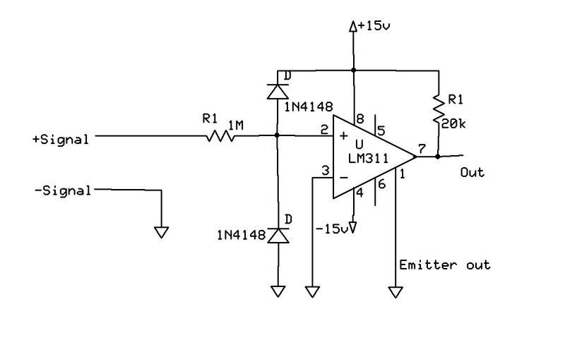

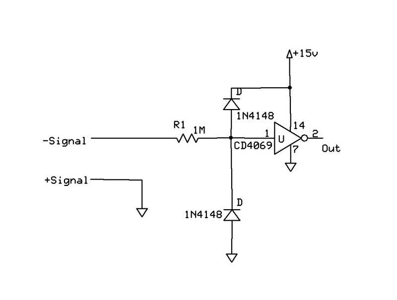

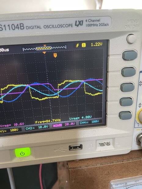

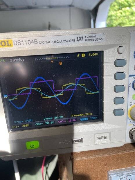

The simple circuit below seems to give me the best, stable results, which I show with wave1. The 1M resistor limits the current since my capacitor can go as high as 750Vrms. The diode clamps keep it between 15v/0v. The inverter squares the signal. Since it is inverted I swapped the signal input polarities. I still have a less than clean signal on the yellow inverter tracing, but things seem good enough for me to put together a PCB with tight tracings and see what happens.
Circuit two uses a comparator to clean the signal. As you can see from tracing there is noise that gets into the output and I do not know how to get rid of it. It appears when the tank capacitor voltage gets high. Nothing changes if I attach earth ground to the system.
The scope probe is x10 and is connected to the output and the ground clip is attached to the power supply ground (same as the signal and emitter out).

Are all probes calibrated and accurate to get a flat line on gnd? and signals protected from crosstalk? The CMOS limiter is expected to perform best.
Ground by definition is any 0 V reference with less error than you expect when measured against itself with ingress noise. ( eg. RF on Protective Earth gnd)
- So if you have grounding issues, measure it and show what your probe shows for ground. (both inputs.)
- Some grounds share unwanted currents, others are used to divert shield emissions to a protective earth ground for a differential pair.
- Often you only connect a shield to earth at one receiving end to avoid the ground loop.
If ground noise is still excessive, define what you expect and show how you measured it.
Another gnd issue is harmonic resonance from scope ground inductance on a fast rising step pulse ( usually > 20 MHz and can be filtered out on DSO filter option or reduce ground clip length to tip and coaxial ring.

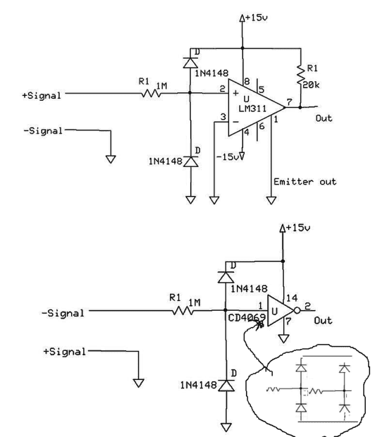

You claim to have a ground problem, but your circuit does not show the power supply grounds, nor the signal grounds, that you are considering. Signals should not connect to supply grounds that carry circuit power, except at one point. You should differentiate between signal and power ground on the diagram.
The LM311 circuit you show has two clamping diodes with a 1 Meg limiter resistor. But why is one diode connected to the +15V supply, while the other diode is to ground? They should each be connected to a ±15V supply, or both to signal ground. That would give you switching symmetry about ground. If connected to supply rails, the diodes will have a minimum reverse voltage capacitance as the signal crosses zero, than if they were antiparallel to ground. At the same time, I expect the 1 Meg resistor terminals will be more of a capacitive divider than a resistor at that slew rate.

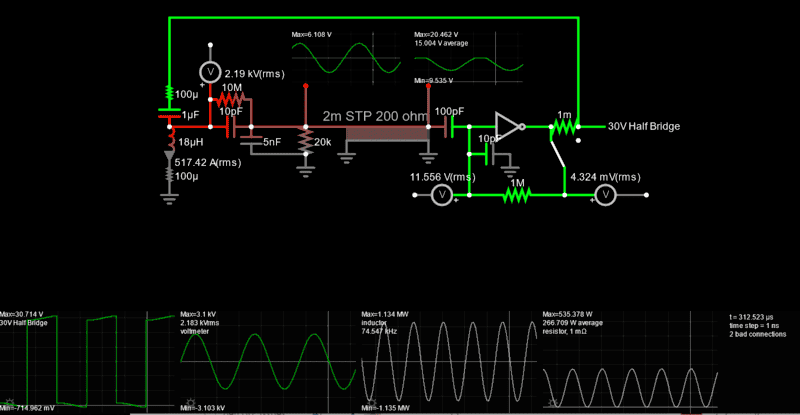

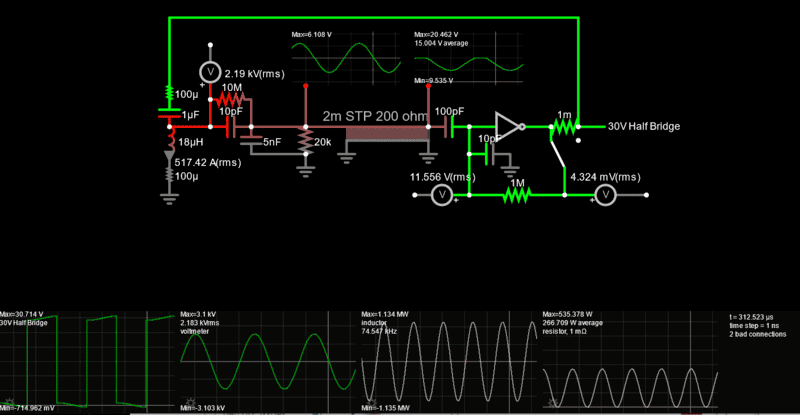

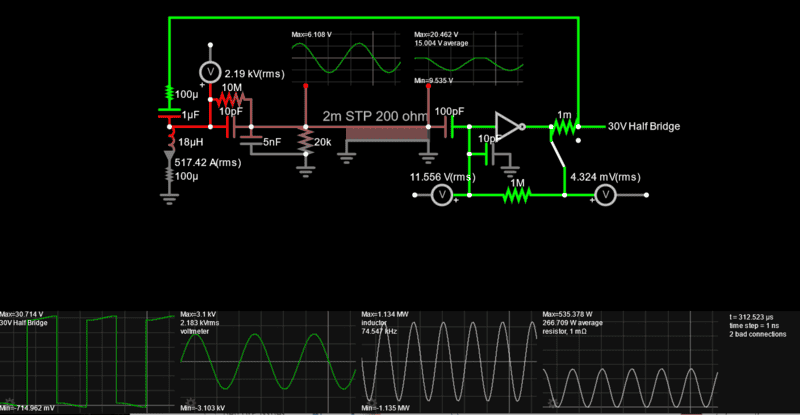

For giggles and kicks, here's my 500A 2.5 kV Induction heater 30Vdc self-resonant to 75 kHz with a 1 mohm half bridge. https://tinyurl.com/2qs592a2 The coil might be 1" copper tubing with cooling.
In theory that's about 1.5 MW
Note this is all based on the Q of RLC's shown with a 2m cable in between the LC tank and the amplifier with DC self-biasing to Vdd/2 and automatic self-resonant oscillation. No uC needed.
After 30 ms it is 750 Arms >2 MW 3kVrms with 1kW losses in the bridge (0.05%). Is this big enuf :cool:
I tried it with both the -15v rail and 0v rail. Both "appeared" to give similar results so I went with the design that did not need a -15v source. I don't mind putting together another PCB using a 15v and -15v supply if you think it would give a "better" timing of the zero crossing. I may just do it to see if it matters. I just saw that the 15v/0v system worked.
The above is true yet not the reason for your problems.

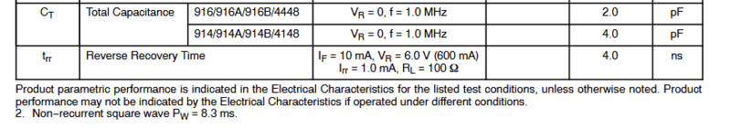

Both circuit schematics use the same diode clamps to +15V and 0V. Although the datasheet worst-case specs are 4pF at 0V where it is highest for the 1N4148 the nominal specs are < 1pF. But more importantly, it is the attenuation and phase shift of the signal that is critical at the input switching threshold. So indeed one might suspect the 0V reference of the LM311 to be worse than the Vdd/2 threshold for CMOS it would not account for the distorted signals shown which occur from different variations of harmonic resonances that affect amplitude and phase of each to create a distorted recurring wave shape. This means the distortion is due to things not shown in the schematic, like parasitic impedance of the cable from magnetic ingress of harmonic currents.
If one wishes to perfect this signal capture, one needs to show all physical and spectral properties of all conductors of the emitted wave and captured wave.

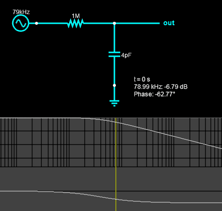

I apologize this is obvious to me but hard to communicate, but easy to capture by a good photographer. I will try to explain my part and expect similar effort if you want to resolve your issues.

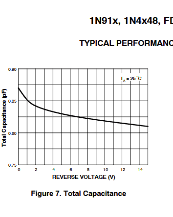

The 4pF max from one diode would introduce almost 60 degrees phase shifts at 75 kHz and 8 dB attenuation, yet graphs are always typical and not worst case. Meanwhile, all CMOS devices already have 50 k current limiters on the inputs with 2 stages of Schottky diode pairs from Vdd and 0V. I sketched that on your schematics for the Hex inverter.
You do not need -15V , but there are better designs such as a balanced Instrument amplifier but the biggest problem is the unknown parasitic impedance in your cables from driver to sensor and the emission signals. This means , driver harmonic leakage, sensor uH/m, pF /m shielding effectiveness and common mode rejection to signal and ground from unbalanced impedance ( between signal vs ground return) and lack of Ferrite choke (CM filter) Shielded STP wires with balanced Differential input amplifiers have fewer problems.

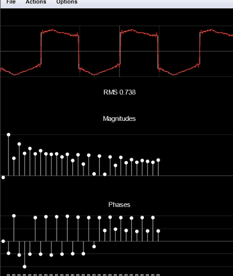

I took your 400V yellow signal , hand drew it and displayed the FFT up to 30 harmonics in log amplitude with phase distortion computed (+/-180 deg)
FYI only to prove what I said about spectral impedance distortion.
The 1 Meg resistor is excessive, a couple of resistors in series to withstand the voltage, while totalling between 47k and 100k, might be a better choice for a limiter, to give lower phase shift. Diodes have capacitance, but when it comes to picofarads, we must consider all the circuit wire capacitance.
CMOS static protection does not have the power dissipation necessary to limit a circuit input voltage. A professional should never rely on input protection when designing circuits.
