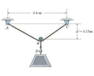

If the 1.5 kg block is suspended from the pulley B and the sag of the cord is d = 0.15m, determine the force in cord ABC. Neglect the size of the pulley
They don't even give an angle, I am not sure how I am supposed to do this.
Draw a perpendicular from BD on AC. That bisects AC.
In triage BDC you can all the three sides.So fond the angles.
so for the angle i got 53.3 degrees. Tan^-1(0.2/0.15) = 53.3 degrees
Then i made components
Force x y
AB -ABsin53.3 ABcos53.3
CB CBsin53.3 CBcos53.3
14.715N 0 -14.715
X axis = 0 N
CBsin53.3 - ABsin53.3= 0
y axis = 17.715 N
CBcos53.3 + ABcos53.3 = 14.715 N
so then i substituted for CB = ([14.715 / cos53.3] - AB)
= 24.62
and got 12.3 as the tension total. thankyou
i was confused by how the lines in the diagram are different sizes and did not think that the pulley would be in the center with a diagram like that
