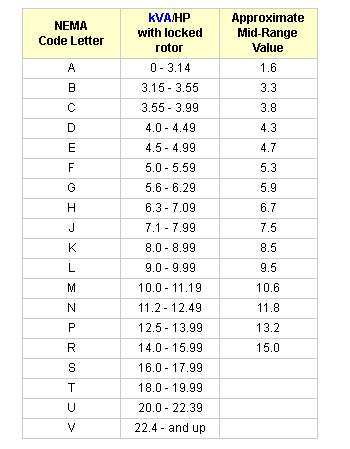

Motors draw several time rated current during startup. See
https://www.engineeringtoolbox.com/locked-rotor-code-d_917.html
The source is not "stout" enough to hold up under your chiller's starting current.
What is the KVA code of your motor on its nameplate? And its horsepower ? How does that compare to the nameplate of your building's supply transformer ?
Somebody should have specified a motor with KVA code that's early in the alphabet.
In my Nuke plant Westinghouse did that for motors that have to start from our diesel generator. Little details make a big difference.

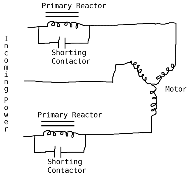

Sounds like this was the initial configuration. The Primary Reactors limited the inrush current and after speed was obtained the Shorting Contactors close to supply full line voltage to the motor. I can conceive of a similar function with autotransformers but best get a schematic of what exists before further speculation.

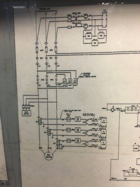

Thanks Jim. I couldn’t find a good nameplate on the motor but it’s not an overly big motor. Main power fuses are around 100-120 amp fuses. I know I’m not giving
^Sorry I’m a newbie. Here’s my circuit. Only the reactor has been replaced with an auto-xfmr tapped at 80%
