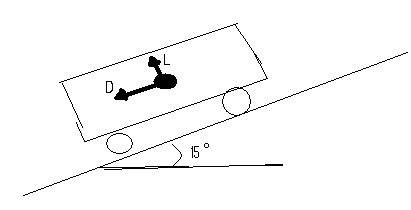

The 2800lb car is moving at constant speed on a road with the slope shown. The aerodynamics forces on the car are the drag D=280 lbs, which is parallel to the road, and the lift L = 112 lb, which is perpendicular to the road. Determine the magnitudes of the total normal and firction forces exerted on the car by the road.
Newton's Laws
[tex]\Sigma[/tex]F=0
I made the xy plane as if the slope of the car is the x-axis, and the direction of the Lift force is technically the positive y direction. The car is traveling up the incline, which I made the positive X-axis. So the plane is slanted a bit.
When doing my forces, I figured that you have the Drift for (D) going in the negtive x direction, the lift force (L) going in the positive Y direction, you have the Normal force which is perpendicular to the car also going in the positive Y direction, and then you have the mg force that the car exerts in both the negative X and negative Y direction (since the XY plane is slanted).

For part 1, correct your typo; you had L=112 lb, but you used L=120lb. Otherwise, you did well, but you forgot the friction force in your Sum of Fx equation (which you later aded in). The friction force is the force betweeen the car's tires (front tires if Front Wheel Drive) and the road. It is this friction force that drives the car forward in the positive x direction.
So when I draw the free body diagram, the friction force is an arrow parallel to slope, and in the direction of the positive X-axis(the car going UP the incline)? I thought that friction forces act in the opposite direction the object is moving?
Yes, when you draw the FBD of the car, the (static) friction force acts on the car in a direction up the plane. By Newton's 3rd law, the friction force of the car on the ground acts in the opposite direction, down the plane.
Yes, correct, the tire is rotating clockwise, pushing back (leftward) on the road down the incline. The road pushes on the car up the incline, rightward. It's like walking, you push back on the ground with your feet, and the friction force of the ground pushes you ahead.
