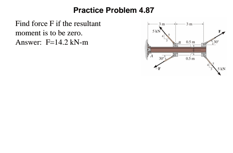

This is the problem I'm having problems with.

Now back to this one. I separated each force into its components. I THOUGHT the perpendicular distanceof the 5kN forces was 3m and the perp distance of F was 1, but that didn't work out and I'm not getting the result. I saw a solution online
I don't understand why they are using both components and why two components of different vectors, say the x components of the F vector and the x component of the 5kN vector, they have the same distance, WHHYYY? Why can't I apply the same logic as before?

Yes the magnitude of a couple is force times perpendicular distance, but in your case the perp distance is not readily determined, so it is easier to break up the force into its x and y components. Then the magnitude of a couple is the algebraic sum of the couples of each component. Note in your example that the x component forces also have a perp distance between them because of the 1 m separation. The solution clearly shows this.
