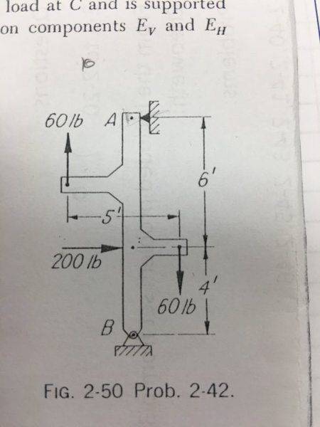

I need to sum the moments on a and b but when i sum them at b the number I get doesn't work when I check and sum them at a.

(-200x4)+(-60x2.5)+(-60x2.5)+(rbhx10)=rbh=110
(200x6)+(-60x2.5)+(-60x2.5)+(rahx10)=-90
Sum horz=0=110+200+rah if moments summed at A
Rah=-310
Sum horz=0=-90+200+rbh if moments summed at B
Rbh=-110
Why are they not the same I don't understand
Should be rah
The sum of the horizontal forces must be the sum of ALL horizontal forces. There are 3 forces with horizontal components. This sum equals zero and has nothing to do with the point about which you choose to sum moments.
Another forces equation can be obtained by setting the sum of ALL vertical forces = 0
