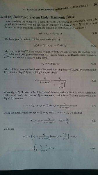

HI,
I am studying vibration, came across this in a textbook and can't see the steps taken to substitute e.q 3.5 into 3.3. There is a second derivative x so where does this go, as there is no s^2 either and I can't see how cos was eliminated
Cheers
##cos^{\prime\prime} (y)=- \cos(y)##
