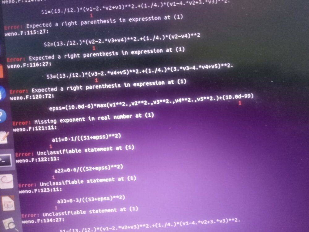

Help with these Fortran Compiler Errors please
In summary, you have a mismatch between the number of left and right parenthesis, and there may also be an error above that one.
Chaitanya_90
TL;DR Summary
Please tell me the reason for error in following image of Fortran code
What is the reason for error while compilation

Looks like you at least have a mismatching parenthesis error. Try counting the number of left and right parenthesis to be sure that they match.
You're nicer than I would have been to someone who didn't even bother to type - paste, really - in his code.
Unfortunately, there also appears to be an error above that one.

As @Vanadium 50 has remarked, you are not supposed to post code, or problem statements in general, as images. You are supposed to put your code directly into your post, inside a "CODE" block--see the "BBCode Guide" link at the bottom left of the post window for more details.
It seems you have a statement not shown in your snapshot that is missing a right parenthesis.Go back and look at your function calls and expressions.
Often when you get a stream of errors, it pays to look at the first one only and fix it and then recompile to see what remaining ones you still have.
This. The fact we are seeing unbalanced parentheses might be due to something upstream.
Or not.
We can't tell.

"parenthesis" - is v an array ?
"exponent" - what's the upper limit on exponents in reals ?
"unclassifiable" - does Fortran use interpuncts ?
Fix the first error before you look at the others as they may go away.

Your code listing doesn't match the error report line numbers. The error on line 112 is shown in your code listing at line 102. Have you dropped some lines from your code listing.
Also screenshots are very poor ways of conveying this info. You could instead capture your error report to a file.
Lastly, we aren't here to debug your program for you. Earlier we asked you to focus on the first error and if you checked your parenthesis balancing prior to line 112 in your error report. Have you done these things yet?
paranthesis i checked again its fine but i don't know the reason for error, maybe spaces or indentation might be causing the error
What is the first error message?

The OP has let the Mentors know via PM that s/he found their mistake. Thanks to all who tried to help; the thread is now closed.
