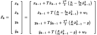

4) In the link I posted, in this equation:
where does the part before the parenthesis come from? Why are there two for x and two for y?
I think the 'T' is the elapsed time between two consecutive steps. The expressions in the matrix look like truncated Taylor expansions that give the coordinates of the k th step in terms of data for the previous step. A Taylor expansion (in this case) would be a power series in the variable 'T' so it it weren't truncated, it would have all the integer powers of T in it.
