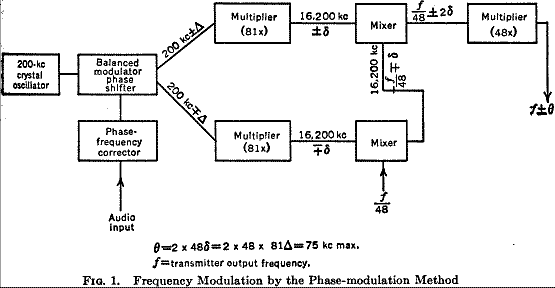

40+ years ago we were using I/Q for RF systems without fancy digital electronics (some used tubes) and there was no DSP involved. I'm sure you've heard it called the 'phasing method' or ‘Weaver`s method in the 60's for SSB.
Armstrong FM TX
http://traktoria.org/files/electronics/communication/A_Third_Method_of_Generation_and_Detection_of_Single-Sideband%20Signals__Weaver.pdf
My point was not to say the traditional way of understanding carriers and side-bands as analog signals was an unnecessary requirement because it is fundamental knowledge but things move on in technology with SDR platforms becoming the norm instead of a expensive piece of gear for professionals. So a clear understanding in the beginning of how these systems work will help a person with the circuits they see today and tomorrow.
