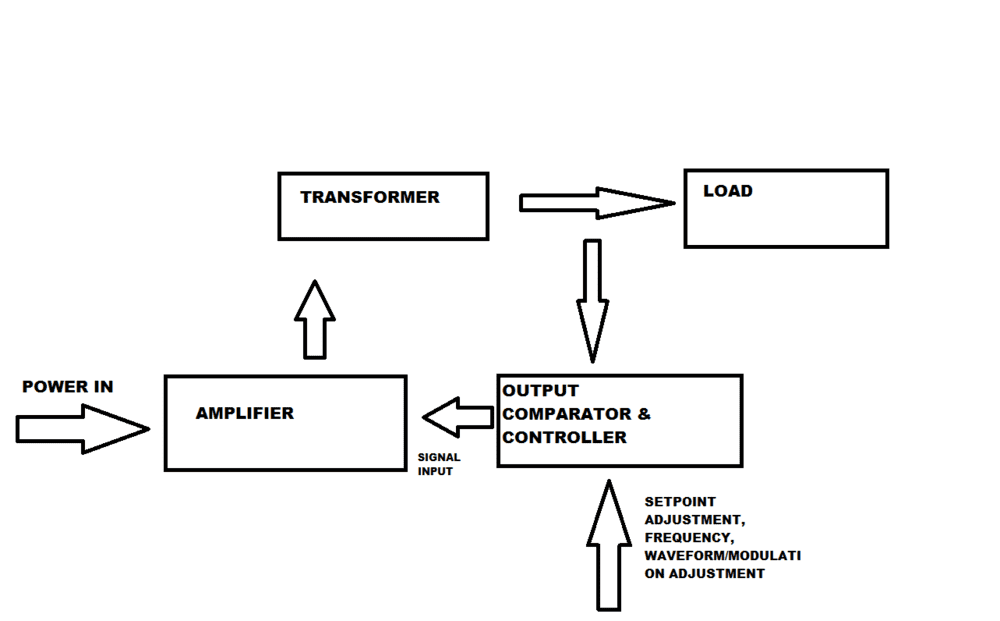

Hello, I am looking for a controller whether programmable or otherwise that could function as a drive and control circuit which would monitor a transformer output connected to a load and then drive an amplifier with a signal that is proportional to the needed one in order to control the output accordingly.
The idea is as follows, I set in certain parameters in the controller, like for example
1)waveform= sine
2) phase angle between U and I = 0
3) amplitude =100v
4)frequency = 50hz
Then the controller inputs a signal that is proportional to this (except for voltage ofcourse) into the amplifier and the amplifier drives a transformer , the output of the transformer is connected to a load , the controller monitors this output and tries to keep the output to match the parameters that I have set for the controller, if some parameters start to deviate from the setpoint then the controller adjusts the amplifier input accordingly until given parameters are again restored.
I suppose that in order to attain good stability the controller sample rate would have to be high enough so that the changes don't start oscillations etc
I have attached a block diagram of my envisioned setup,
could you please give me any ideas in which direction to look for such circuits and IC's or maybe there is already a product on the market that does exactly this?
PS. maybe the amplifier could be a class D amp without the analog input and the controller could drive it directly with a high frequency modulated signal which would be demodulated by the transformer in the output to get a sine of lower frequency?
It's not clear what you are trying to control. Is is just amplitude, or amplitude and frequency and waveform and phase? If you watch both U and I at the output, what is the load applied to the output of this device?
Would you describe this device as a signal generator?
You ask about components to buy, but in good design it is best to be 100% clear on what you are trying to accomplish before asking the question "how to do it?"
Likes sophiecentaur
It seems you are building a high power calibrator, and want to eliminate the gain and phase error of the power amplifier while output load changes.
What range of frequency does it need to cover ?
To correct the phase you need a master phase reference input signal. Then use a Phase Locked Loop to adjust the input oscillator frequency, so output phase is corrected.
What are the U and I signals ?
To correct the amplitude you will need an output amplitude detector and integrator, or a true RMS circuit to provide an estimate of the output. Compare that estimate with the required output and change the amplitude of the source, or the gain of the amplifier to correct the error.
Hi, since your system is both generating and also monitoring signals I would suggest that you look in the direction of digital signal processing. There are many processors to choose from but I think that you should look for some 'canned' solutions that are pretty much all in one chip or board.
Check out Analog Devices Sigma Studio for such. Also, a company called miniDSP supplies premade modules that offer a wide variety of features like signal generation, filtering, integration etc. These are intended for audio applications so the bandwidth is up to 20kHz, I imagine that your requirements would be in the frequency range spanned by audio so this is a good place to start looking.

Don't forget the phase difference between voltage and current is determined by the load, not the supply. If you switch out a resistor and switch in an inductor at constant voltage phase, then the current shifts by 90 degrees.
Likes Klystron and zoki85
As anorlunda explained, a calibrator must be set to regulate either current or voltage output.
You are building a “calibrator” similar to a Fluke model 5100, or 5200, but have not specified the precision you require.
Google 'Fluke calibrator' read the Operators Manual.

An accurate power amplifier will be built like an op-amp, with an error amplifier that compares the input with the attenuated output.
Likes hutchphd
Well then I would need two feedbacks, one built into the amplifier that compares the amp output with the input and the other being a more "global" feedback comparing the power going into my load with the waveform coming out of my function generator into my amplifier.
I think having an amplifier with opamp in it's input is not a big deal and can be done easily.
Why do you need to make it so complex with extra global feedback. You need to source a voltage waveform, rarely a current waveform. The power will be decided by the load.
It may be new to you, but the error amplifier is part of the negative feedback used to linearise power amplifiers. It is done all the time. The important thing is to make sure it does not cause instability.
