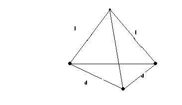

Is it a triangular prism?
The diagram isn't too difficult. You have three masses hanging from a string and all the strings meet at a common point. It's like a pyramid with a triangular base. At the top of the pyramid is the common point and at each vertex of the triangle at the base, are the spherical masses. Is the diagram clear?
Now Draw the Free-Body Force diagram for ANY ONE spherical mass. What are the forces acting on it?
They are
(i) Gravity
(ii) Tension from the string
(iii) The Electrostatic forces due to each of the other spherical masses.
You also know that the whole system is in equilibirium. So, write the components of the forces in the x,y&z directions and equate them. From this, after some trignometry, you should get the final relation.
Diagram
IN EQUILIBRIUM ALL FORCES (GRAVITY, ELECTROSTATIC AND TENSION) are balanced.
BJ
Something like this:

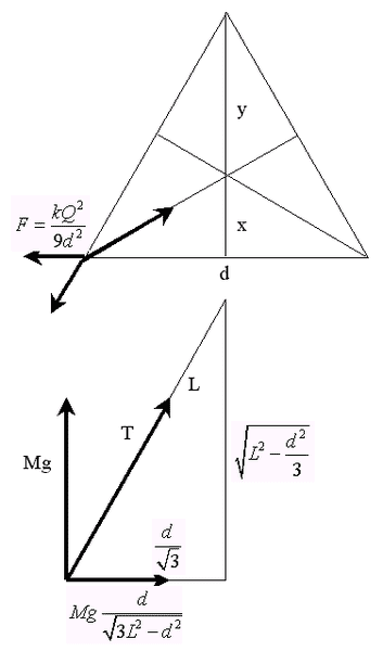

I'm not sure what your original equation is saying, but I think it should say
[tex] {Q\ }^2 = 12\pi \varepsilon _{\rm{o}} mg\frac{{{d\ }^3 }}{{\sqrt {{L\ }^2 - \frac{{{d\ }^2 }}{3}} }} [/tex]
There are three horizontal forces acting on each charge. Two of them are the repulsive electrical forces that can be found from Coulomb's law. Each charge has magnitude Q/3 and they are separated by distance d. The two repulsions form an angle of 60 degrees, and their sum is offset by the horizontal component of tension in the string. The vertical component of tension must equal the weight of the sphere, mg. The horizontal distance from the veritical line dropped from the point of suspension needs to be found so that you can find the horizontal component of the tension in terms of mg, L and d. There are a couple of ways to do that. One is by recognizing that if you divide the equilateral triangle into 6 congruent right triangles, the hypotnuse of the right triangles is the distance you need. You can find the sides of the right triangle from area considerations.
I'll post a diagram that has all this illustrated, including the dimensions of the triangle formed by the string, the horizontal distance from the vertical line below the point of suspension to the charge and the vertical distance from the point of suspension to the charge. See if you can come up with the value of y in the upper diagram that corresponds to the horizontal distance in the lower diagram. Then do the algebra needed ot get the result.
