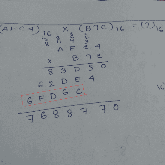

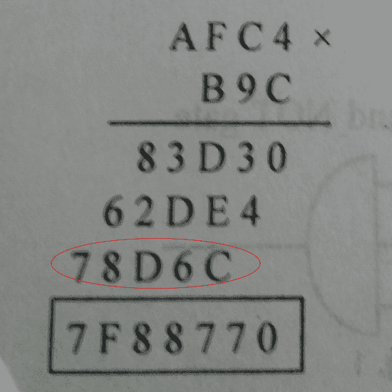

I am trying to multiply hexadecimal numbers.
Here is what my book has given
Here is my solution
book solution and my solution has differed in the red marked area.
which solution is correct?
am I doing anything wrong here? I get 6 F but book wrote 78 in that red marked area.
Need help with this part.
Thanks

The book's answer is correct for the part you circled. I didn't check anything else. I verified this using the calculator in Windows, in Programmer mode.
A possible reason for the number you got is that you didn't carry correctly.

I get the book solution.
You have B * AFC4 = 6E000 + A500 + 840 + 2C and the 6E000 + A000 = 78000

Yes. I made mistake in carry. corrected now.
Thanks. It helped a lot.
