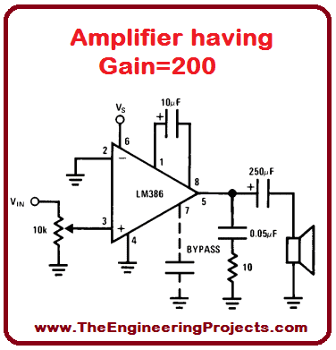

those are the pins number of lm386 SO lm386 have 8 pins
Once you get the op-amp issue straightened out, you may be able to use another AM receiver to generate a carrier. You would do this by tuning into the local oscillator of your second receiver. By using several receivers you should be able to hear the beat between the two local oscillators (the difference in frequency between the two). But cross that bridge when you get there. Listen to @berkeman concerning the 386. He knows what he is saying.
Likes berkeman
michael1978 said:
do you have any idea how to make easy to change that opamp with lm386,
For a start, I would get rid of the TL086 circuit shown and use the LM386 circuit instead. Take your point "A", keep the diode and capacitor out of it, and change the resistor to the potentiometer shown on the LM386 circuit. So point "A" feeds the LM386 input through the diode and cap and potentiometer. That should get you started.
i make it, now what to do? so draw black line of pot where i connected
HELLO, i change yesterday like i show you, but today i make separate the lm386, i hear nothing, what is this in gods name?
Do you know what the voltages around various parts of the circuit are and do you know what they are supposed to be?
