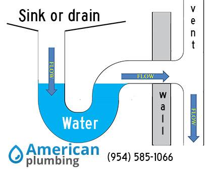

I work on the 24th floor. In the loo, I noticed a standard 4" drain in the floor about 6 feet from the toilets. When the toilets flush, you can clearly hear water gushing down the drain. I'll bet if I shone a light down there, I'd be able to see it dropping down the vertical. i.e I suspect it come out at a straight T-joint, a foot below the drain.
Is this not risky - but more to-the-point - highly unsanitary? I mean, if there's solid waste flowing and sloshing just a foot below that grill - even in normal operation - isn't that spewing bacteria-laden particles into the bathroom proper?
Shine a flashlight into the drain; I'd be shocked if it wasn't protected by a trap.
Likes CWatters
Like this:
http://www.americanplumbingflorida.com/wp-content/uploads/2016/09/p-trap-plumbing.jpg

No, please re-read the diagram. It says drain or sink. Floor drains will generally have p-traps too, I believe. I'm more familiar with electrical codes and not plumbing codes, but I'll try to find a code section to post...
Properly built floor drains have water traps and ultimately they will connect to the same soil drain or stack as the toilets are connected to. How close they connect will determine how easily you can hear the toilets washing past them.
The floor drains get water for their traps from trap primers which drip water into them periodically. If you ever look at a urinal or toilet flush valve and see a small 3/8" water line mysteriously running from them into the wall, that is one way the trap primers get their water. Every time you flush one of them you send a little spurt of water to a floor drain.
These systems are notoriously fragile and often go bad allowing traps to dry out. A dry trap would definitely be noisier than a full one. It would also allow sewer gases to pass through to that room. Custodians typically catch on to this and will allow some mop water to go down the drain every night, but not all of them know about it.

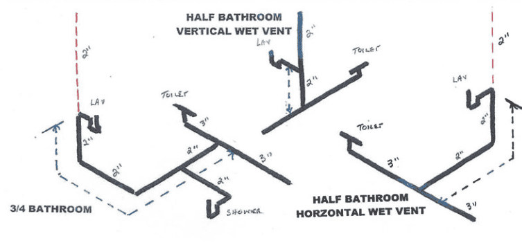

I've seen that too where i worked. Indeed i could look in and see water run by. But never any solids and it never smelled..
Had i seen solids i'd have known somebody took a shortcut and abused the concept of "wet vent"
In that image the toilet is vented through the vertical lavatory drain line..
but i think (dont know for sure) it was one of those automatically primed drains instead, as previous post mentioned. . See this short video:
Armed with those basics you can observe further and figure it out...
I love learning 'tricks of the trade' through studying everyday experiences. .old jim
