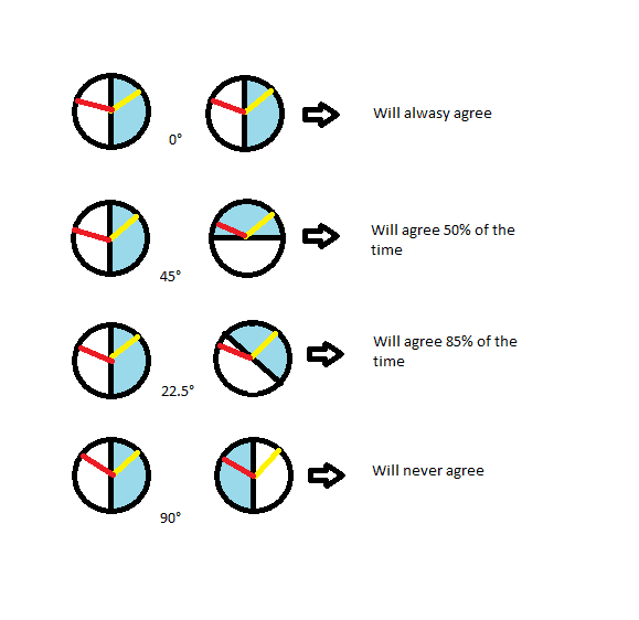

But here's an explanation which involves entirely local variables that can come up with the exact same distribution.
Imagine a vector in a circle. With respect to the horizontal, this vector can take on any angle from 0 to 360 degrees. This can represent some kind of hidden phase the two entangled photons have in common (in the image below, one is colored yellow and another is red; these are just different independent vectors, as if they were on different pairs of photons).
Now what happens at the moment of measurement? There is an angle choice, but no matter what this angle choice is, there will always be a 50% chance to measure the photon. I represented this by coloring half the circle in blue. If the phase vector lands inside the blue area, the detector will blip. What the angle choice does, is rotate the circle. The phase vector is invariant, but it has a definite inclination with the respect to the measurement angle, which is simply the horizontal cutting the circle in two.
The only nuance is that the angle inclination is not linear: so at 0 degrees the two horizontals are the same, but at 45 degrees the horizontal are perpendicular, at 22.5 it is at 15 degrees from the horizontal, and so on. The important point is that the probability is given by the overlap of the blue areas. (note that here the 22.5 is not the correct angle only for ease of drawing)
There is clearly nothing spooky in this setup. The only issue is that it's not clear to me what the circle actually represents, but whatever it is it is a property of the detector, which is nonlinear but still local. From the looks of my diagram, it seems as if the detectors also have a certain "phase", and interaction only happens when both phases are compatible. Here I chose to picture the phase of the first detector always the same for simplicity, but you could rotate it and still get the same result (if you also rotate the other circle by the same amount, which is akin to keeping the angle difference the same). In this sense there is no absolute detector phase, the only constraint is that they must be the same for polarizers at the same angle, which makes sense since they should be, in principle, indistinguishable. As for the non-linearity, I havent really thought too much on how to explain that away, but it eerely reminds me of the relationship between quaternions, which is also non-linear. Here's another analogy: replace the two circles with two ellipses. Now rotate one. The overlap is not linear anymore (see below). An ellipse in general does not reproduce a cosine dependence, but you can just pick a shape that will, it's a matter of geometricizing the problem imho.

Here, the red area represent the overlap between the two ellipses. As you can see, it does not decrease linearly as the ellipse rotates.
In essence, the correlations are an interplay between the state of the photons and the state of the detector.

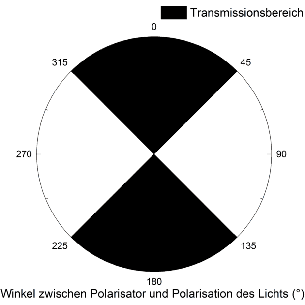

I think a more careful drawing would help. The overlap varies linearly with the angle, leading to a triangular graph that always falls below the cosine law that was found experimentally (and was predicted by QM, of course). The (anti-)correlations are stronger than what simple local models can produce.

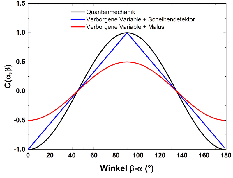

This indeed is the best classical approximation there is, but it still does not match the experimental predictions. Below, I uploaded two figures from my quantum optics lecture which discuss exactly that question (sorry for the German). It considers an entangled photon pair of opposite polarization. The horizontal axis provides the relative angle between the detector polarizer settings. The measurement result is +1, if both detectors do the same thing (both detect a photon or both do not detect a photon) and -1 if both detectors do a different thing. The vertical axis is the mean value for this measurement result. The second figure shows the "detection" and "no detection" ranges for the relative angle between polarization and detector setting.
The red line is the classical hidden value result assuming Malus' law. This is as expected.
The blue one is a "disk" detection model (+ polarization as a hidden variable), which does what you describe. It fires all the time if the polarization (or the phase in your model) is within 45 degrees of the detector setting (or the detector setting +180 degrees of course) and does not fire otherwise. In that case, the detection probability is only given by the overlap given by the "disks" describing the angles. In that case you indeed get full correlation and full anti-correlation. However, this necessarily gives you a linear correlation curve as the overlap is obviously a linear function.
The black line gives you the quantum-mechanical description, which is obviously cos-like. As you can see, the curves agree for 0 and 90 degrees, but are most different for 22.5 and 67.5 degrees. If you have a look at Aspects's first paper, these are exactly the angles he used for the measurements. In my lecture, I usually discuss this detector model to motivate Aspect's choice of angles.

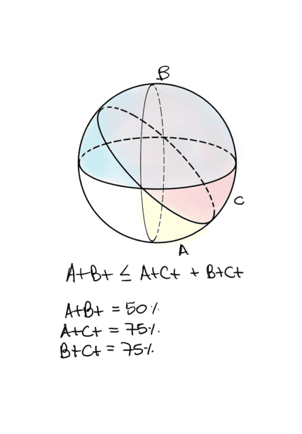

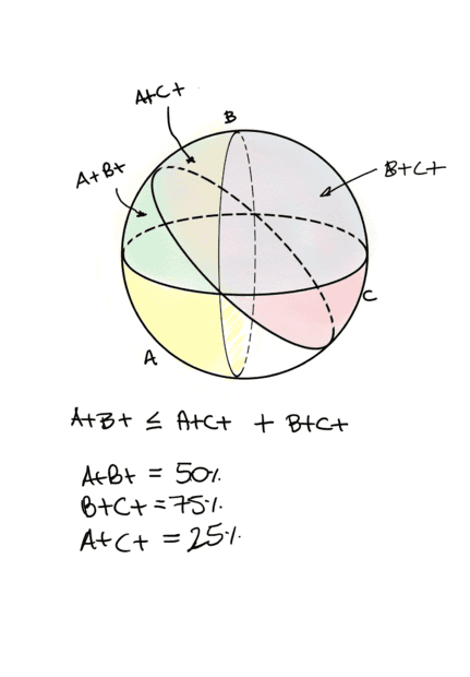

How does your idea work when there are three possible angle detectors?
Likes Nugatory
As in? Sorry I'm only familiar with the polarizer and spin experiments. In the spin measurement experiment you have 3 detectors on each side, but only one at a time ever blips so the idea here should work just the same, with the only difference that you always measure a spin in both. The point is to look at the correlations where spins are opposite or not instead of whether a photon passed the polarizer or not (at least that's how i understood it), but the graphical representation here shouldn't differ.

In your presentation of checks and Xs, you have 4 cases in which there are 2 Xs. If neither of the photons are detected, how could you know they ever even existed? Entangled photon pairs occur at random times. If you don't detect anything for either of the pair, you won't be able to record that case at all. Hence why Bell tests use a PBS with a detector at each output port. They need 4 detectors total: 2 for each PBS (one PBS on left side, one PBS on right side).2. Your statistics (85% match) are correct for the 22.5 degree case. Note this is what actually occurs, and is not necessarily what your model will yield.3. Here is where your problems arise, and there are several of them.
a. Your local hidden variables are the red and yellow "phase" vectors. You say the photons have these "in common". On the other hand, you describe them "as if they are on different pairs of photons". My assumption is that you are in essence trying to show that the red is what we might call trial 1, and the yellow is trial 2. If this assumption is incorrect, please let me know. For each trial, we have photons L (Left circle) and R (Right circle) which are entangled and encounter a detector which is model by the blue semi-circle. If this is incorrect, please let me know.
b. The 4 different detector cases are not drawn to scale and are off by a factor of 2. Your 90 degree case (the 4th) is drawn as if they are 180 degrees apart - even though your purported statistics match what would actually occur in experiments with a PBS.
c. So... you will need to be explicit about your formula, because from the drawing it is not clear when we will get an H outcome on one side, or when we will get a V instead. I would expect your rule(s) to spell out how you get those. Note that the @PeterDonis comment about each rule applying separately is critical. The results must occur independently if you are pushing a local model.
As I understand your rule: if there is overlap with the semi-circle and the colored line, then the outcome is certain for that side (either L or R). This does in fact "work" for the 0 degree, 90 degree, and probably the 45 degree cases. But...
d. Here is where your model goes wrong. You claim - without providing a formula to match - that the 22.5 degree case yields the correct 85% results. It doesn't!! Your model actually yields a 75% match rate, well off from the true expectation value. That's because the overlap between the 2 semi-circles (L and R) is only 75%. It's that overlap % that drives your formula. (i.e. That's how it works for the other 3 cases - 0%, 50%, 100%.) A more rigorous mathematical derivation of this result is possible, but suffice it to say that you cannot "fix" the 22.5 degree case without breaking one of the other cases. 4. Additional comments:
