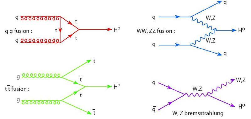

Yeah it can happen like that. Here are the most common ways Higgses can be produced:
The purple diagram shows the Higgs being produced along with vector bosons. If the vector boson is a Z, then the Z decays like 20% of the time (or some such) into a neutrino-antineutrino pair, which escapes the detector and gives you your missing energy. I don't know details like how much, I'm not an experimentalist :p.
You can see from these diagrams that there is a bunch of junk you can get along with your Higgs; jets (from the quarks), extra leptons, missing energy. There is also lots of junk that can come from higher-order diagrams than those four. It gets tricky.
