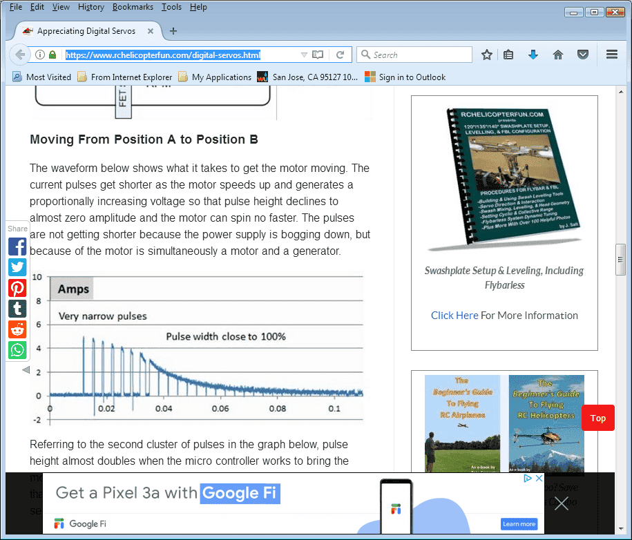

Are you coordinating the multiple servo drives to minimize the total and peak currents required from the power supply?
https://www.rchelicopterfun.com/digital-servos.html
Likes davenn, kolleamm and Klystron
