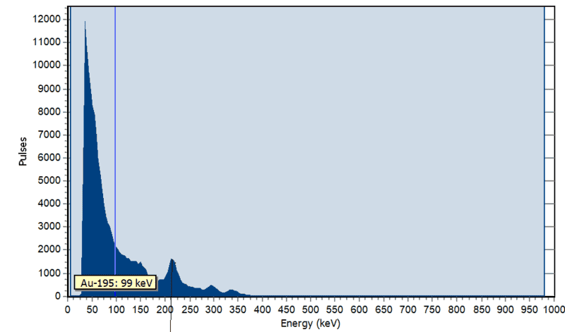

we have continued with a measure of the given material that with a Scintillation counter which gives the following result.
this gives us a peak at 210 keV which is not measured at a background measurement. is there a good site were we can find the possible decay's that may have caused this peak?
It could be lots of things, including x-rays from the detector itself.
