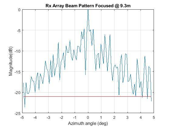

I am doing some research on High Frequency Linear Array beam forming (for imaging sonar). For that purpose, a linear Rx Array of 100 channels have been constructed with inter channel spacing of 14.3mm. A transmitting Tx probe operating at 420 KHz (approx. 300 cycles CW pulse) is placed at distance of approx. 8.9m from Rx array in water tank of dimensions (Length=12m, Width=8m, Depth=8m). The depth of Tx probe and Rx array is around 4m. The array data has been simultaneously acquired at sampling rate of 2Msamples/s/channel using NI ADC cards. The ADC cards and pulse generator for Tx probe are accordingly synchronized.
I have done some array beam forming on Rx array data along with focusing (at 9.3m approx.) and beam pattern result is drastic (far worse than simulated one) and shown below. The useful sector is around 10 degree and MATLAB 'chebwin' shading with -21dB side lobes has been used.
If someone has done such work and if he/she is interested, i can share digitized raw data of Rx array in MATLAB '.mat' format so that he/she can beam form this data and share beam pattern results with me?Unfortunately, i was unable to attach zip file (containing .mat file) in this forum. I want to know in steps where is issue?, in my processing, in setup or in both?

Summary:: Higher side lobes observed in Receive Array Beam Pattern in water Tank. (Continuation of work previously posted as 'Linear array beam pattern')

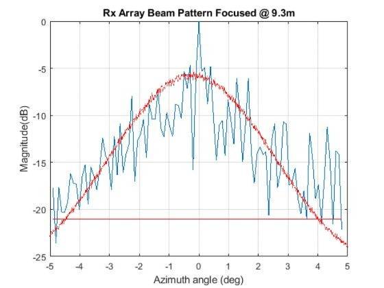

I look at your problem from a post processing point of view. As a hobby project I have developed a maximum entropy noise reduction algorithm for image processing. I acquired the data from the image you posted using opencv and applied it to my c++ routine.
My algorithm is a modified version of the algorithm developed in the paper, J. Skilling and R. K. Bryant, "Maximum entropy image reconstruction: general algorithm", Mon. Not. R. astr. Soc. (1984) 211, 111-124. If you think it would be helpful for your research I can process some more of your data.

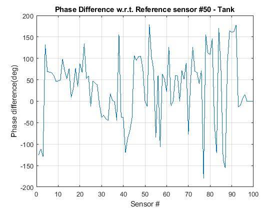

With transmitting probe in front of array at 8.4m distance and focusing at receive end being done at 9.3m, the simulation results of Phase difference b/w reference sensor (i.e. 50) and rest of sensors is shown below:
The actual results received using same scenario in Tank are shown below:
Issue is that these phase differences vary with even slightly change in setup, e.g. Transmit probe position, relative depth etc.
That suggests you have a reflection from the water surface interfering with the direct path.
Change the surface and see if it changes the pattern. Maybe float a sponge or a shaggy carpet on the surface to destroy the perfect mirror.

As I have observed during testing that phases of preamplifiers vary among them, is it possible that different acoustic sensors also have phase variation among them (irrespective of phases due path differences)? And if yes, is it any way to measure these phase variations ?

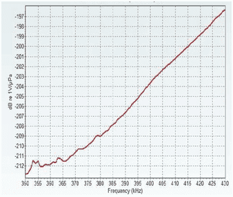

If you are operating close to a transducer resonance you may get phase differences between transducers.
What is the make and model of the sonar receive transducers? Do you have a datasheet? What is their resonant frequency?
I am using customized developed transducers with following receive sensitivity vs frequency graph:

The path is 8.9 m direct,
or reflected via bottom, side or surface is 4 metre away.
What is path length via 4 metre side or surface reflection ?
2 * Sqrt( 4.45^2 + 4^2 ) = 12.0 metre which is 3 metre further than the direct path

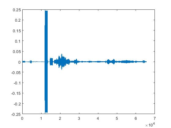

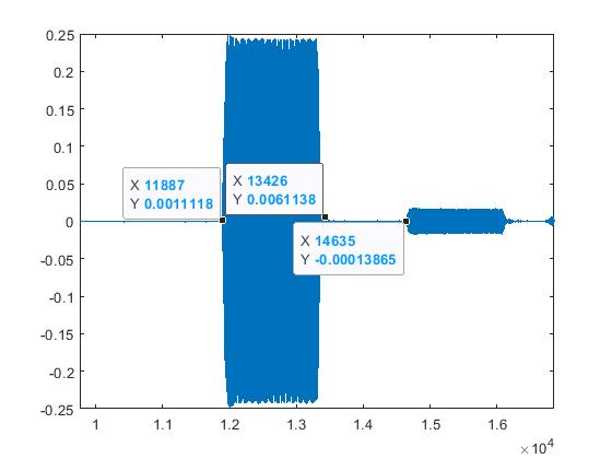

The tank is large enough to contain the 1.057 m long pulse without reflections from the walls or surface.
The sampled data needs to include a quiet period at each end.
nauman said:
On reception side, i am acquiring around 33ms data of each sensor data
You should be using less than 1 msec of data since after that, the multipath reflections will make a mess of the signal.
1. How do you identify the start of valid data? Maybe first arrival time at any sensor?
2. How do you identify the end of valid data? Maybe 1 msec after start?
3. How long is it before the first indirect reflection arrives? Maybe 1.5 msec.

The raw data of middle sensor (i.e. 50#) is as:
The zoom data of direct pulse and indirect pulse is as:
As sampling is being done at 2 Msamples/s, direct pulse start time is approx. 5.94ms (11887/2e6) which is around 8.85m using sound speed of 1500m/s. The indirect pulse start time is approx. 7.3ms (14635/2e6) which is around 10.95m. The time difference b/w both pulses is around 1.4ms approx.
Before doing beam forming, i only use direct pulse data (e.g. in above case samples from 11000 to 13500 only) and force other data to zero in software for all sensors.
OK, so you use only direct signals, and have eliminated all tank boundary reflections.
You will find the spurious phase variation in the last place you look, because then you can stop looking, but where should you look next?
1. The separation between the elements in the array is 14.3mm, which is much greater than the wavelength of 3.52 mm. That will lead to ambiguity of received phase. The main lobe will have a null at Atan( 3.52 / 14.3 ) = 13.82°;
The 100 element * 14.3 mm = 1430 mm long array will require a rigid mounting with alignment accurate to better than 0.3 mm at the ends of the array.
2. Coaxial transmission lines will look like capacitive lumps at 420 kHz. If lines are not all the same length there will be phase differences due to reactive transducer loading. Those should be steady repeatable errors.
Cables can be microphonic. Are cables subjected to 420 kHz in the water? Or do cable bundles drift, flexing in the water? That would produce variable phase errors.
3. Can you describe the physical connections for the channels. Where are the filters and pre-amplifiers located, and are all the interconnections the same length. I would look for hum loops where ground currents flow in signal cables, or through the water.
4. Is the water in the tank absolutely still, or is there circulation that could introduce Doppler shifts?
5. Is there a low frequency rumble such as a heavy motor, Air Con, or road noise present? That could position-modulate the phase at the transducers.
6. If you reduce the TX pulse by 20 dB, or 40 dB, does the spurious phase still occur? That will eliminate cross-modulation in RX transducers and processing electronics.
Likes berkeman
  • #31
As separation is greater than (wavelength/2), 'grating lobes' occurs but beyond +/-6 deg. That's why only +/-5 deg sector has been used here. The sensors are mounted on a rigid water tight hollow cylinder outer surface with preamplifiers/filters fitted inside the hollow cylinder. There is approx. 0.5m coaxial cable b/w sensor and corresponding preamplifier. The two water sealed 18m long cable sets each carrying 50 preamplifiers/filters output goes to surface through two glands in hollow cylinder.
  • #32
Changing the RX array position very slightly changes the RX phase differences significantly. That suggests there is cross-coupling between the signals somewhere other than in the water.
I can't see how to progress investigating signal integrity without all detailed circuit and mounting information. Such as;
What is the tube made from? Is it grounded? How and where are the signals and power supply grounded.
Or;
Are the 18 m long cables each 50 twisted pairs, or 50 coaxial cables. How are the two ends of those transmission lines terminated to prevent reflection? and what about cross-talk?
When you compare the phase of an element against the two adjacent elements, is the phase difference of the first few cycles the same as the difference for the last few cycles, or does phase vary during the RX pulse? Are some, or all, channels unreliable?
