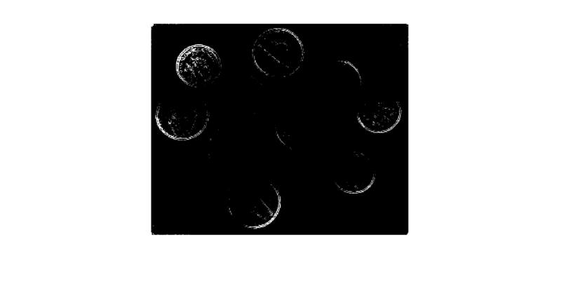

I am having a slight issue with my code and honestly cannot understand what I am doing wrong. I am currently trying to using a high pass filter in the frequency domain to form the following image.
So my approach so far after numerous of attempts which I won't list as I believe I am on the correct path, is to use a low pass filter matrix and then subtract from the original image, the issue is I cannot subtract due to the matrix of the low pass filter image being different from the original.

The image being produced from this code is shown below
But when I run the code to subtract the I get the error code:

As you can see I have tried to make the images the same size yet it still is not working and I am at a slight loss to why.

I have found that the images were of the same size but the class was not however when I subtract the images the outcome is not what is expected. So this leads me to either my method is wrong in the fact that I am using the wrong kernel or the enitre program is incorrect.

Unfortunately I don't have a copy of Matlab to experiment with at the moment. But here's my thought about the mathematics of what you're doing. You want to apply filter D to image A, ##DA##. And then subtract that from the original image, ##A - DA = (1 - D)A## where "1" means the identity matrix.
So maybe you might try 1 - D as your high-pass filter? Or in Matlab, eye(3) - D?
BTW, this simple rectangle filter is probably not an optimal low-pass filter anyway. The FFT is a sinc function which has long tails, meaning it will leave a lot of high frequencies.
