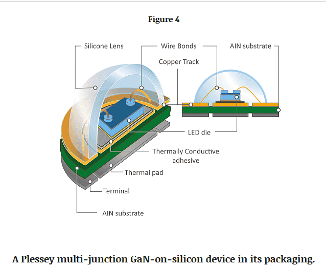

I think you can get a reasonable estimate of the die size from this figure from the first link that I posted to the Plessey power LED information:
...and the datasheet info for their 7070 series LED that the article talks about. It looks like the base is 7mmX7mm, so if you assume that the drawing above is to scale, that will let you estimate the dimensions of that die. Datasheet info found here:
https://uk.rs-online.com/web/p/leds/1696969
Likes Solid-Statist
Let’s give this a shot…
In the drawing, the high-power LED die is about 1/5th the length of the 7x7mm package, so the die length would be 1.4mm and its area about 2mm^2.
The Plessey datasheet notes a power level of up to 15W for the device, so that would mean the maximum thermal load on the die could reach 7.5 W/mm^2, or over 4800 W/sqin. Does that sound right?

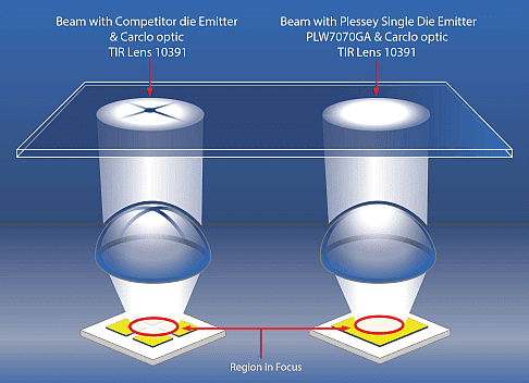

The Plessey paper on LED Single-Die Solutions notes that this configuration has an advantage over "multi-junction die" in that there is no dimming or shadowing in the light output at the gaps between dies (see below).
