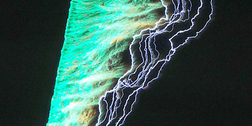

It was 20+ years ago that I read that book, so take it with some salt: one of the very first devices built for experimenting with plasma was more or less worked by the method you described. It was easy to build: you needed only a transformer with a BIG core (to store up as much energy as possible), then stop the DC current through the primary and watch what happens in the gas tube attached to the secondary...
The plasma channel worked ~ the way you described: the current trying to shrink the diameter, but the temperature tries to expand it. There was one additional feature to it, what made science abandoning this setup: the channel was not stable. The initial arc was 'blown up' to some random curve-like shape (just what you can see on any vid about long DC arcs: like here [moderator: link removed] at 9 min - what an ***** idiot...) really fast.
Apparently even the last real usage far predates the Internet, so it is hard to find relevant documents (or I'm lacking the necessary google-talent for this): I could not find anything useful. I'll try some more before giving up.
Ps.: for any Mentor: please feel free to remove the link if this level of unpreparedness and carelessness is not acceptable here - but it is hard to find a really good DC arc.
Ps2.: that book was from the unlucky side of the Cold War, and it was old even that time I read it. Nothing useful popped up from google. As of new sources, the closest to this direction would be about 'pinch', I think.

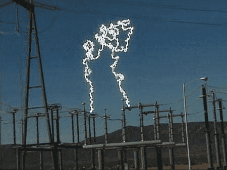

But the instabilities you mention are also true for AC arcs, so maybe this picture will help make your point.
Edit: It also makes me think of rocket triggered lightning experiments that my company used to perform. In the picture below, the straight line arc was the wire. But subsequent re-strikes follow the plasma path remnants of earlier strikes, except that those plasma paths are displaced downwind. Note the kinky shape of those paths, incipient instabilities. The horizontal green streaks are vaporized remains of the wire.

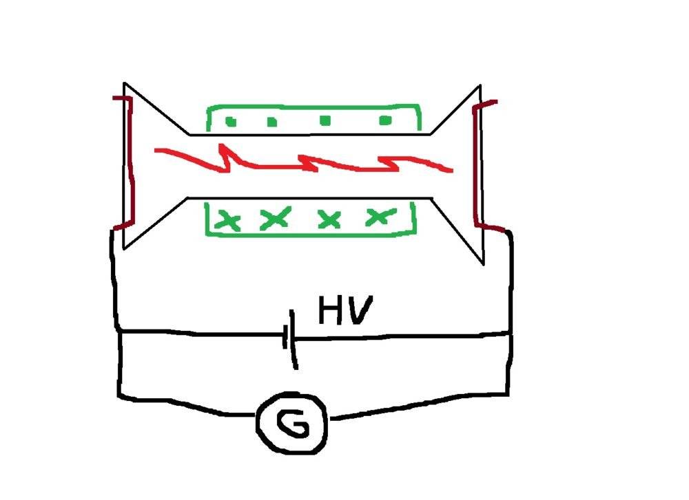

pinch.jpgWell, I read some articles where scientists at Sandia labs and elsewhere have seemingly created some ways by which to minimize or eliminate the Birkeland current instabilities,(I would have posted the links but they did not explain precisely how they did it)
Speaking about the electrode area, in theory since the device is pulsed, maybe one could have wide ends like in the picture while a smaller diameter center, I believe some of the devices are or have been already made in such way.
@Rive by the "unlucky side" of cold war I suppose you mean the USSR?
I do wonder what is the effect of a strong axial E field during the current burst of such a plasma because the current drives the plasma hot as well as there are proton and electron axial velocity within the plasma at that moment which is what confines them as their motion through the field tends to push them towards the middle, although I would suppose that increasing their axial velocity their gyroradius while traveling along the field lines would become smaller and so maybe the confinement would be even better?
Because as I understand what one wants is a maximum current and plasma temperature but then once that is achieved also a maximum "squeezing" of the plasma and confining it to a thinner radius so that in order the current could have a better effect and the total fusion rate and confinement time in the pulse would increase?PS. I see these pinch devices can have both a solenoid type magnet which produces a field where field lines are in the axial direction and particles would follow the lines looping around them and there are devices that use axially shaped current carrying wires or a cylinder which creates a field seemingly perpendicular which then pushes the plasma current towards the center since two currents in the same direction repel one another, I wonder have these two field approaches have been combined in a single machine, I did not find any specific examples.
