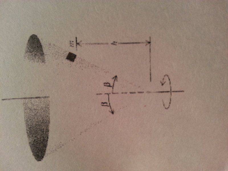

The problem is:
An amusement park is replacing it's stand-up roller coaster with a G-Force ride. Riders will enter the ride at the apex and lean against the wall of the ride. The G-force ride will speed up until riders reach height h above the apex. Determine the minimum speed v needed to keep riders at a constant height h (in terms of h, β, μs, and constant g). Given the wall of the ride make an angle β with the vertical, and the coefficient of static friction between the bodies and the surface of the walls is μs.

I have tried using the equations above in attempt to see if any can be used to solve this problem, but I am completely stuck. I do not know where to start and I am very confused as to how this problem can be solved.
I have attached a picture to give a better understanding of the problem.

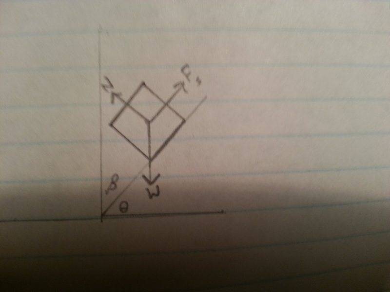

I doubt this is correct, but this is the free body diagram I came up with.
It's not correct. What is Fa?
Use the picture given in the problem description as a template. That slope needs to be there somewhere.
Imagine you're standing (or leaning against) the slope of the ride. Name each force you're drawing and describe why you think it should be there. Think of what's the difference in tems of forces present when the ride is rotating vs when it's standing still.Don't just drop a picture - describe your thought process. Surely, you must have some ideas, however silly they might seem. We can't help you if we don't know what you're thinking.

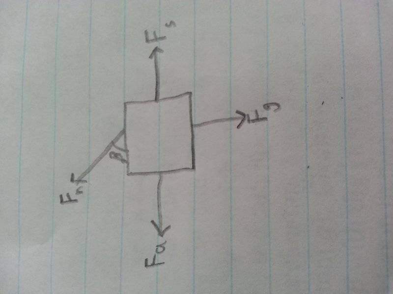

Alright, thanks! Sorry it took so long for me to reply. This is the free body diagram I came up with. Am I on the right track?

Kailford said:
one thing is that my teacher has told the class to not use the term "centripetal" or "centrifugal" forces, saying that they are fictitious forces
That's not correct. Centrifugal force is 'fictitious', yes, but centripetal force is real. However, it is not an applied force, such as gravity or mechanical or electrostatic. Instead, it is a resultant force required to achieve a curvilinear motion. It's perfectly ok to refer to centripetal force as long as you treat it that way.
It's also ok to use centrifugal force in non-inertial frames, but my own preference is to avoid that.
