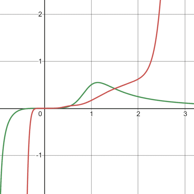

- Highschooler develops a new integration technique that works on 73% of the common integrals used in Calculus 2 named Maclaurin Integration.
Where most integration techniques can only be applied to around 10% to 40% of integral problems, Bruda’s technique applies to approximately 73% of integrals. That means it is almost two times more effective than most mainstream techniques.

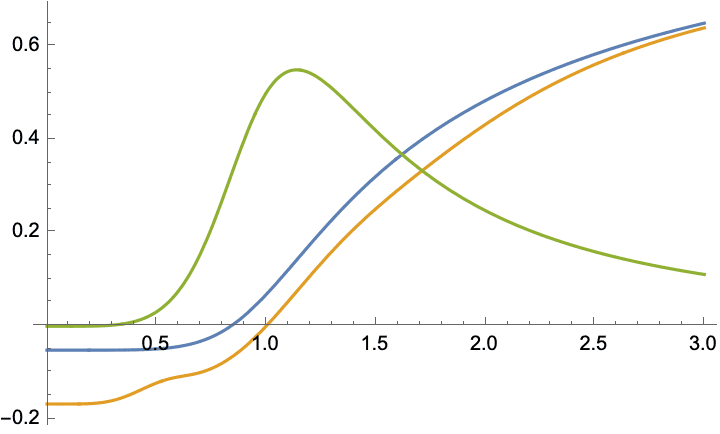

That behavior is caused by the fact Bruda truncated the inner summation, keeping only 11 terms. Mathematica was able to come up with a closed form for the infinite sum, and when I used that, I got the following plots:pbuk said:Haven't properly read it but I am afraid that if in the chart in section 3.3 the red line is supposed to be the antiderivative of the green line then there is something badly wrong.
Ref: arXiv:2201.12717
I was pointing out your suggestion that his method was flat out wrong is wrong. I'm not sure what you're saying about ##x>2##, unless you're perhaps mistaking the graph of the function for the graph of its anti derivative. You seem to have something against the high school kid. Why so much hate?pbuk said:So are you saying that you think that Bruda's method is useful, he just picked a bad example to demonstrate it? Catastrophically bad: his result is convex for x > 2 whereas the solution is concave?
I'm comparing the red line in this graphvela said:I'm not sure what you're saying about ##x>2##, unless you're perhaps mistaking the graph of the function for the graph of its anti derivative.
I expect to be similar (after a vertical shift) to some level of approximation.vela said:my orange curve is shifted vertically from his.
Not at all: if my comments could be construed as hateful then please suggest an edit or report them.vela said:You seem to have something against the high school kid. Why so much hate?

I didn't really get through the whole thing, but I seem to remember something about the method being valid over the domain (0, 2) for the opening example.pbuk said:So are you saying that you think that Bruda's method is useful, he just picked a bad example to demonstrate it? Catastrophically bad: his result is convex for x > 2 whereas the solution is concave?
Ah yes, this is indeed the case and is mentioned in a couple of places, but critically not in relation to the chart in section 3.3 which confused me.valenumr said:I didn't really get through the whole thing, but I seem to remember something about the method being valid over the domain (0, 2) for the opening example.
So yes, it was a bad example - or rather a poorly illustrated example. I have sent the author a constructive note.pbuk said:So are you saying that you think that Bruda's method is useful, he just picked a bad example to demonstrate it? Catastrophically bad: his result is convex for x > 2 whereas the solution is concave?
I'm not sure why you'd expect this when he truncated one of the series whereas I didn't. It's like expecting ##x-x^3/6## to behave similarly to the full series for ##\sin x## for ##x \gg 1##.pbuk said:I expect to be similar (after a vertical shift) to some level of approximation.
It's just that your comments came across as unnecessarily negative and dismissive. (It could just be me.)pbuk said:Not at all: if my comments could be construed as hateful then please suggest an edit or report them.
This is pretty much what I wrote to him, and he has acknowledged.jasonRF said:So my friendly suggestion for improvement is for him to prove to himself where his formula is valid, make this more explicit in the paper, and only plot examples in regions where the formula is valid.
