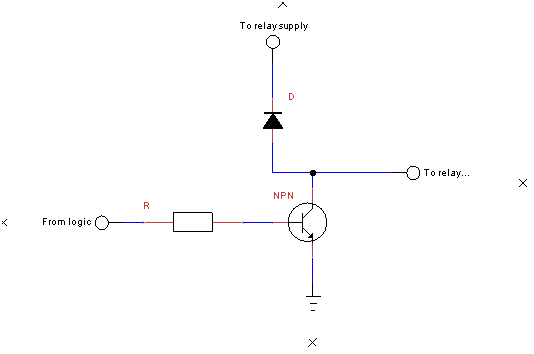

I have to work with control units at my new job and I am not sure what something being driver high side versus low side mean? let's says we have a motor connected to a microcontroller unit. if one end +ve of the motor is connected to the controller and the other end of the motor is connected to ground, does that mean it is driven low side? would there be a voltage limitation is such a situation as it the controller can only give small voltage max, like say max 5 volts or maybe 9?
High side means there is a switch between the voltage source and the motor. Low side means there is a switch between the motor and it's ground.

As I said, a low side driver is easy because the logic generally will interface directly to the driver (see figure).
As you remarked, a high side driver needs some sort of level translation between the logic and the power device.
Oh yeah --- 1 transistor if the supply voltage is above the logic voltage. That's really a lot more complex.</sarcasm off>
