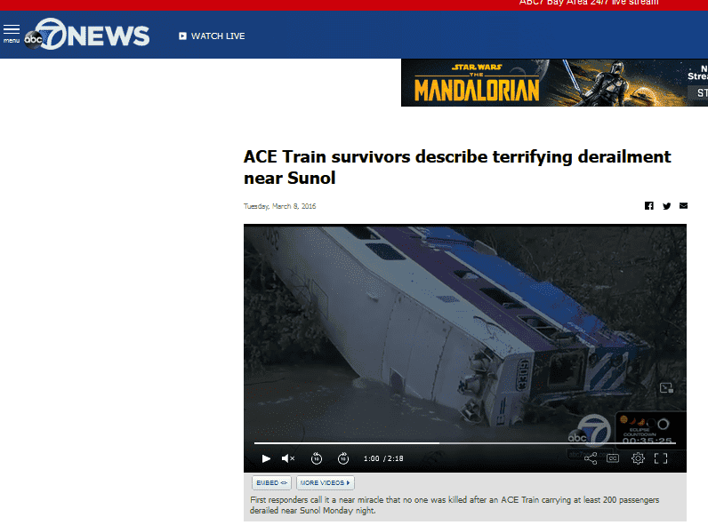

Interesting, I did not know that. We've had a few issues (and at least one derailment) over the past few years for commuter trains going through Niles Canyon east of Silicon Valley. I've never seen such a sensing fence on my car/bicycle/motorcycle trips through Niles Canyon, so I don't think we have that system. Are there criteria that trigger the requirement for such a system? (If I were riding those commuter trains daily, I'd sure want that system in place!)
https://abc7news.com/train-derailment-sunol-niles-canyon-road-alameda-county-ace-service/1235998/

It may be based on historical experience. I've seen such fences on the Denver, Rio Grande & Western (DRGW; now part of the Union Pacific railroad) in Colorado, and on the BNSF near Glacier National Park in Montana. I don't believe they are mandatory, but up to the railroad to determine the risk.
On highways, one will often see barricades and steel mesh fastened to the rock faces.

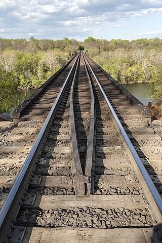

I would like to add one more thing on mitigating damage caused by Hazmat derailments in populated areas.
On RR bridges, it is common to install Guard Rails.
The Guard Rails do what one might expect by guiding the inside de-railed wheel to follow the track, even at high speeds. Rail cars are far less likely to tip (or fold up the train) when still rolling on ties (rather than ballast), while crossing bridges or other nearby structure that is financially desirable enough to protect. It would be an added expense on track through populated areas, but this principle could serve quite well to protect valuable citizens too. Afterall, we fund various effective guard rails on our highways with good reason.
I do not believe the Guard Rails even have to be new, just sound. Used rails are used in yard switching tracks and sometimes even sold to small spur lines, but I think most rails are scrapped. In addition, with enough national change-outs taking place, it might not be too hard to re-gauge a Spiker to put them down. Many specialty and periodic track maintenance items are now done using outside contractors. In-house M.O.W. (Maintenance-Of-Way) are being thinned out. In-house M.O.W. are a highly skilled craft struggling to cover more and more miles per man. Perhaps too many. Professional in-house M.O.W. workers know much more than I do about RR structure of course.
Even with Guard Rails, there may still be a problem with the train crew even realizing that they are off the track. But a gimmick used for detecting slides should do the trick. Slide fences, sometimes made of hog-wire, simply tug on sets of spring-loaded switches that throw a signal on approach. I believe there is little reason to think that a sort of "switching-plate" could not serve to throw a low power radio alarm (like Hot-Box) and/or signal, when a switch-plate support, strategically placed between the Guard Rails, is crushed by heavy wheels on the ties, thereby closing contacts. Then upon alarm, some nice, smooth, electrically assisted braking could really make some of our worst community disasters a non-event. Sure, the train crew would still be discouraged by their rudely interrupted trip. But not as dramatically, nor rudely as they are now.

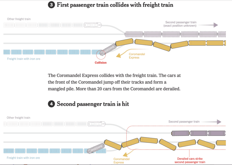

There was a derailment in India followed by a three train collision. I have read what happened (and it's largely news sources quoting each other) but do not understand what happened. Apparently, a train was cleared to go on one track, somehow ended up on a parallel track and hit a freight train on that track. Then a train in the opposite direction (how then was the first train cleared?) hit the derailed cars.
I presume this will be cleared up over time.
  • #34
The schematic in this BBC News article says the two passenger trains were on parallel tracks in opposite directions. One train shifted onto a third track (how that happened seems to be the mystery), hit the freight train and derailed, concertina-ing into the side of the other passenger train.
  • #35
I had heard that the train in question was on the correct track (middle of 3?) had 7 of 9 cars derail, some of which clipped the parked freight train. That caused the more major pileup with some overturned cars and such. Then the higher speed 3rd train came in (before it could react to the incident) and hit the accident scene. It wasn't clear if the 3rd train was informed and was already beginning to slow down.
The difference seemed to be that it wasn't operator error (train on wrong track), but rather a maintenance issue that allowed a derailment to occur during normal usage. As is said above, there's a lot of news agencies just quoting each other (sort of like chatGPT training on material posted by past language models), so what I heard might be completely wrong.
I remember (a decade+ ago?) a German high-speed passenger train that lost a set of wheels/axle altogether in one rail car. Tension on the train kept it aligned and going straight. It was only when it began decelerating that the tension was released and the truck was pushed sideways due to the compression. The train (from the offending car back) hit a bridge abutment at something like 250 km/hr and stopped abruptly. It was eventually blamed on maintenance and failure to inspect as I recall.
  • #36
Ibix said:
onto a third track
Thanks. That clears it up. When In was reading "the other track", I didn't realize they meant "the other other track".

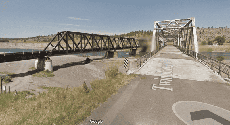

BNSF's Yellowstone River Bridge (near Reed Point, MT) is out of service after it collapsed under a BNSF train, and the parallel automobile bridge (Twin Bridges) is temporarily closed. It is a main line for BNSF between Billings and Bozeman. The bridges are located in Stillwater County, between Reed Point to the west and Columbus to the east. One could see the bridges from I-90.
https://www.yahoo.com/news/train-derails-yellowstone-river-prompting-165417989.html
https://www.ktvq.com/news/local-new...acility-plant-shutdowns-in-yellowstone-county
I appears high water (and high flow) in the Yellowstone River undermined one of the piers in the middle of the river. Attached image shows what the bridge normally looks like at low water and before the collapse.
Stillwater county is experience flooding along some streams south of Columbus, MT.
  • #39
Astronuc said:
It appears high water (and high flow) in the Yellowstone River undermined one of the piers in the middle of the river.
Ah, I missed that in my earlier news report readings today. Those reports did say that they had high waterflow recently, but it was not known if that contributed to the collapse. Still, you have to wonder how a bridge design got approved if it can be so affected by high river waterflow. It looks like a short bridge, so likely only a single center support that was pile-driven into the riverbed?
  • #40
I don't know. I believe it was stone and concrete. I was looking for details.
It could have been built in 1897. A similar bridge on the railroad collapsed last year (2022) in Park County.
The highway bridge was apparently demolished, which is why it does not appear in current images of the collapsed railroad bridge.
https://www.ktvq.com/news/local-new...-bridge-near-reed-point-in-danger-of-collapse
https://www.montanaoutdoor.com/2021/05/yellowstone-river-to-reopen-at-two-bridges-road-bridge/
Apparently, heavy scouring undermined the piers of the highway bridge.
