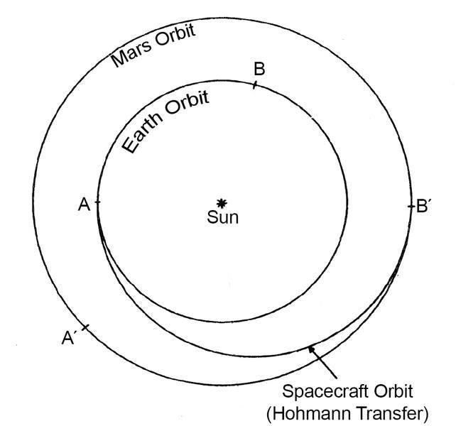

I have to solve a rather extensive task. Most important are questions a) and c). I appreciate any help :)!
The task: Determine characteristics of a Hohmann transfre towards, when circular planetary orbits around the Sun with [itex]R_E = 149.6 \cdot 10^6 km[/itex] for Earth and [itex]R_M = 227.9 \cdot 10^6 km[/itex] for Mars are used.
The task:
a) How does the true anomaly in [deg] of the Earth's position between start and arrival of the satellite change?
b) What is the angle [deg] between Earth / Sun/ Mars when the satellite arrives at Mars?
c) How many days before opposition (Earth is on a line between Sun and Mars) the launch from Earth must occur to arrive at the apocentre of the transfer ellipse, when Mars is to be encountered.
In different sub-tasks I was already able to identify following.
The orbit transfer time [itex]t_H = 258.8 [days][/itex]
The orbital velocity of Earth [itex]\nu_E = \sqrt{\frac{\mu_{Sun}}{R_E}} = 107224.1113 \frac{km}{h}[/itex]
The orbital velocity of Mars [itex]\nu_M = \sqrt{\frac{\mu_{Sun}}{R_M}} = 86870 \frac{km}{h}[/itex]
The angular velocity of Earth [itex]\omega_E = \frac{360^\circ}{365[days]} = 0.9863\frac{deg}{days}[/itex]
The angular velocity of Mars [itex]\omega_M = \frac{360^\circ}{686.795[days]} = 0.5242\frac{deg}{days}[/itex] (received from the orbital period T).
a) For the true anomaly I only found a formula covering the "One-tangent burn" orbit changing technique: [itex]\nu = \arccos{(\frac{a_{tx}(1-e^2)/r_B-1}{e})}[/itex]. However I do not know, if I can apply this formula to a Hohmann transfer.
b) The satellites travels [itex]180^\circ[/itex] in [itex]258.8 [days][/itex] in the same time. The Earth travels [itex]255.2544^\circ[/itex] and Mars travels [itex]135.6629^\circ[/itex]. Since Mars only performs [itex]135.6629^\circ[/itex] we must have given him a headstart of [itex]44.3371^\circ[/itex]. So the angle at start is [itex]0^\circ[/itex] between Sun and Earth and [itex]44.3371^\circ[/itex] between Sun and Mars. At end the angle between Sun and Earth is [itex]255.2544^\circ[/itex] and [itex]180^\circ[/itex] between Sun and Mars.
Is this correct?
c) From b) I know that Mars needs a headstart of [itex]44.3371^\circ[/itex]. Hence I was able to calculate how many days must have been passed until Mars is in the opposition of earth.
[tex]\omega_E \cdot x = 44.3371 + \omega_M \cdot x \Leftrightarrow x = 94.48 [days][/tex]
After 94.48 days after start Mars opposes Earth. In addition I have no idea how to solve this task :).

I think I understood the question b). It is asked for the angle [itex]\angle \text{Earth }\text{Sun }\text{Mars}[/itex]. Hence it has to be as following
[tex]\angle ESM = \omega_E * t_h - (44.3371^\circ + \omega_M \cdot t_h) = 0.9863 \cdot 258.8 - (44.3371^\circ + 0.5242 \cdot 258.8) = 75.2749^\circ[/tex] Did I get it :)?
In regard to a):
We have defined the true anomaly as "the angle between perigee and the current satellite position in its orbit". The perigee defines the closest point to the object of interest and the apogee (or apocentre) the farthest point. Unfortunately I am not able to apply this knowledge to the circular orbit, we are using here.
The attached image file displays our situation. A and A' are the position of Earth and Mars at the beginning of our Hohmann transfer. B and B' display the position at the end of the transfer. From a first understanding I would guess the the true anomaly equals the answer of b) since the satellite is at Mars' position. But here I have neglected that it has to be the angle between perigee and the satellite's current position. I just took Earth position in regard to Mars.

In (a), you are asked for a change in the true anomaly. You don't have to care about an absolute value. The rate of change is just the angular speed of the object.

Close. The first two digits (75°) are correct. The rest are not. You are using inconsistent values, so your result is only good to two places. Another problem: You should only report four digits of accuracy because you were only given distances to four places.
In regard to a):
With a circular orbit you can pick any arbitrary point as the periapsis point. Since the question is asking for the change in true anomaly, it doesn't matter what you select as that arbitrary point.
In regard to c):
I have calculated the days necessary until Mars opposes Earth relative to the start of the Hohmann transfer (94.48 days) NOT relative to the satellites launch on Earth. I have no clue, how many days in before a satellite has to be launched to perform such a hypothetical Hohmann transfer to Mars.
You have already determined that Mars needs to be ahead of Earth in terms of angular displacement at the start of the transfer and will be behind the Earth at the end of the transfer. Somewhere in between the Sun, Earth, and Mars will be in perfect alignment. The question is asking what time this happens, relative to the start time.
