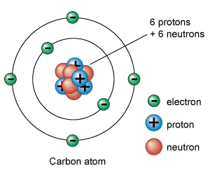

You may think this way with the figure, the atomic model : Stable elements usually has the same number of electrons, protons and nuetrons.
Electrons around the orbitals are fixated or attracted by opposite charge protons, but the only thing is, electrons are arrange in energy levels or orbitals. The farthest or the outer most orbitals experienced low attraction force as compared to the nearest 2s electrons, so more often if a force field is applied to it, which is greater than the binding force of the atom's protons, electrons at the outer shell will be easily displaced. Once displaced, this will result to a positively charge atom-meaning electrons are missing, obviously. When electrons are missing, we term this as "hole", could be similarly thought as "electron vacancy" -my personal term.
