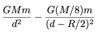

A spherical hollow is made in a lead sphere of radius R, such that its surface touches the outside surface of the lead sphere and passes through its centre. The mass of the sphere before hollowing was M. With what force, according to the law of universal gravitation, will the hollowed lead sphere attract a small sphere of mass m, which lies at a distance d from the centre of the lead sphere on the straight line connecting the centres of the spheres and of the hollow?
(diagram below)
F = G*m1m2/r
I solved that the hollowed out mass is M/8, which is correct. I don't understand why it is incorrect to substitute the remaining mass (7M/8) back into the F = G*m1m2/r to produce the force. Why is the solution the force of the whole lead sphere minus the force of the “hole” lead sphere, which is
? What effect does this "hole" have?
Thank you.
This idea is superposition. The force at mass ##m## due to a full sphere is greater than that due to the hollowed sphere because there is more mass. To get the force due to the hollowed sphere, you need to subtract the force due to the smaller sphere that you took out in order to create the cavity.
Likes PhDeezNutz and PeroK
Because the remaining mass doesn't have its center of mass at the same position !
Likes PeroK, jbriggs444, erobz and 1 other person
Also, somewhat more subtly, because the remaining mass is no longer spherically symmetric. So Newton's shell theorem no longer applies, so the gravitational effect of the remaining mass is no longer guaranteed to be identical to that of an equal point mass positioned at a particular mass center.
Pithy version: Center of mass and center of gravity are not always synonymous.
