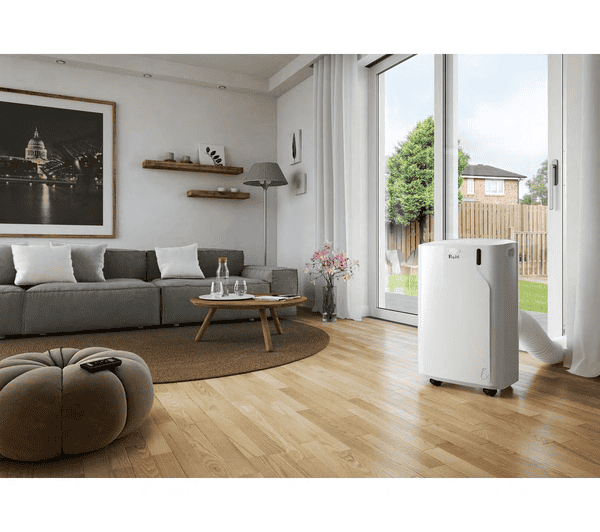

Why do portable air conditioners work?
I am seeing lots of brands of home portable air conditioners to cool rooms. They are sold through well known nationwide chains such as Currys, Argos in the UK. Customer feedback shows that they really work.
But why would they work??? Surely, these portable aircons need to take away heat from the room, and the heat can only go inside the machine!
Evidence: www.currys.co.uk www.argos.co.uk
search for : portable air conditioners

I just chatted to Currys' adviser, and he told me there is no connecting pipe to the outside. So I told him I'll ask a science forum why it works.
Then he doesn't know his product very well. There must be a way to vent the hot air outside of the room or else you get as much cooling as opening your refrigerator door. None.
Likes Edwina Lee and russ_watters
There are two general types of these portable coolers. One is based on a heat pump and the other is based on evaporation. The heat pumps have a vent to the outside. The evaporative coolers do not.
The evaporative coolers work on the same principle as sweating. The heat is put into water which is converted from liquid to vapor in the process. They only work well in dry air, and when they are working they make the air more humid.
Likes RobbyQ, PeroK, AlexB23 and 1 other person
That must be it. They are only evaporation coolers.

A poor arrangement for the exhaust tube to be exiting through a half opened door. The slot width can be estimated by looking at the overlap between the two sliding doors. I wonder if there's a suggestion that a proper vent hole in the wall could be better?

The portable ones you linked to have exhaust ducts and are true air conditioners.
Note that whatever volume of exhaust air is vented to the outside, must then be replaced by hot, humid, outside air, no matter how it gets in. That makes this type of A/C only slightly better than useless, particularly in the type of humid environment that I happen to live in.
I've had one of these for decades and they work great. I've lived in a virtually windowless loft with only six inches separating me from the blazing sun, and that was only possible because of one of these devices. (The only window is tiny and it's 15 feet from the bed. That's why I went with a portable.)
There's only one connection to outside. They pull air from the room and vent it outside while pouring cold air into the room. The exhaust is very warm (you REALLY want to insulate that vent hose). They are also effective at lowering humidity. They don't have a drain because they use the exhausted heat to evaporate and vent the accumulated water.
You are saying that a one-pipe system with air coming in from outside is not as good as a system that uses two air cycles (effectively three or four pipes?) because it involves drier air already in the room being re-cycled and further dried? I guess that makes sense.
Thermodynamics can be confusing but is the COP better because the ΔT of the circulating outside air is less for a given heat exchanger temperature (I.e. room cooling power)?
Fridges seem to be a simpler system to appreciate.
Likes russ_watters
"Two pipe"
outside(warm) to outside(hot)
inside(cool) to inside(cold)
(no air mixing)
"One pipe"
inside(cool+warm) to outside(hot)
inside(cool+warm) to inside(cold)
(inside air partially replenished by insiderer air)
You could design a unit that uses water as a hot-transport-medium, that has no air hoses. This will seriously annoy some people.
I suppose the kind of system that DaveC describes works best in an environment where the outside air being pulled in is comparatively cool and dry (don't you live in Canada?), and the main heat load is radiant from the sun. On the steamy Gulf coast where I live, I don't think they're so great.
The ductless split systems from, for example, Mitsubishi, and commonly retrofitted to older buildings in Europe, use Freon as a hot-transport-medium and have no air hoses. I think they work very well, but obviously they cost more.
Likes DaveC426913 and russ_watters
