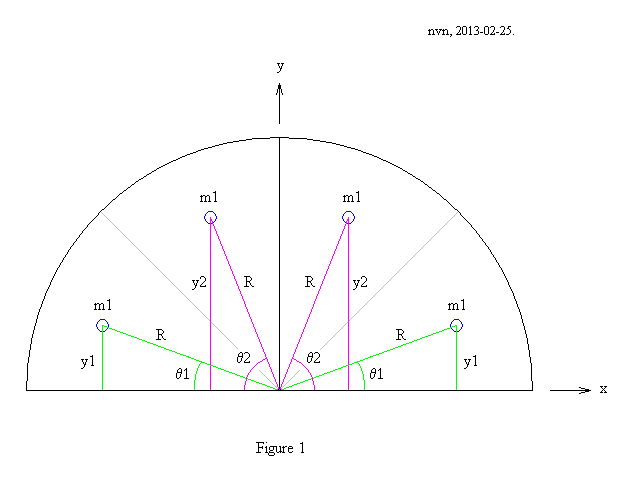

Last thing before I start my calculations, isn't w suppose to be w = 8*m1*g/(theta*R) instead of w = m1*g/(theta*R) ?
dislect: Only if you change theta in post 2 to 2*pi rad, then you would need to multiply by 8 in the w formula numerator. But as currently written in post 2, no, do not multiply by 8.
(3) To compute the stress on your upright pipe, probably load only half of the table top, plus add some force corresponding to someone pushing downward on the table top edge. Compute the summation of moment about the table top centerline, M2. Then compute the bending stress on the pipe, sigma2 = M2*(0.5*D0)/I2, where I2 = pipe moment of inertia (second moment of area). Ensure stress level Rty2 = sigma2/Sta does not exceed 100 %, where Sta = 155 MPa.
E.g., just as an arbitrary example, if D = 1050 mm, D0 = 75 mm, R = 420 mm, m1 = 2.1 kg, t2 = pipe wall thickness = 2.4 mm, and a person presses downward with a force of 250 N, then M2 = 2*m1*g*R*sin(22.5 deg) + 2*m1*g*R*sin(67.5 deg) + (250 N)(0.5*D) = 153 860 N*mm. I2 = (pi/64)[D0^4 - (D0 - 2*t2)^4] = 361 040 mm^4. Therefore, sigma2 = (153 860 N*mm)(0.5*75 mm)/(361 040 mm^4) = 15.98 MPa. Therefore, stress level is Rty2 = 15.98/155 = 10.31 %, which does not exceed 100 %, and therefore currently indicates the upright pipe is not overstressed.

two questions:
1. why are the angles 22.5 and 67.5?

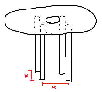

3. how would the calculations change if i was to create the "stand" out of 4 pipes connected together to create a shape of an even square? i want to compute the stress on two out of four connected pipes while table is loaded on the half of it, supported by those pipes. picture:
(distance x is between pipe centers)

dislect: (1) In Figure 1 of the attached file, you want to compute summation of moment about the table top x axis, with only half of the table top loaded. You need moment arms y1 and y2, shown in Figure 1. In Figure 1, you can see, theta1 = 22.5 deg, and theta2 = 67.5 deg, for a 45 deg sector angle. Therefore, e.g., moment arm y1 = R*sin(theta1).

(3) I currently have not investigated item 3 in post 14. By the way, you do not necessarily need to switch to four pipes just because (if) your original, single pipe is overstressed. You could simply increase the single pipe D0 and/or t2 value, until your original, single pipe is not overstressed, if you wish.

(3) I'm switching to four because i want to mount my electric motor on two of them, and supply the table with a better basis on the ground

dislect: (3) You can compute the force on the leg pipes described in post 14, item 3, as follows. Compute summation of moment, M2, about the x axis, as described in post 14, item 3, and post 15, item 1. After you obtain M2, then compute force P2 = -M2/[x/cos(45 deg)], where x = leg pipe centerline spacing, shown in post 14, item 3. Also compute force P1 = -(pi/theta0)(m1*g)/4, where theta0 = sector angle in radians, which I called theta in post 2. Then, compute P3 = P1 + P2. Force P3 is the maximum axial force on one leg pipe, for your leg configuration shown in post 14, item 3.
The stress on a leg pipe is then sigma3 = P3/A3, where A3 = leg pipe cross-sectional area. Ensure stress level Rty3 = abs(sigma3)/Sta does not exceed 100 %, where Sta = 155 MPa.
The stress on a leg pipe is then sigma3 = P3/A3, where A3 = leg pipe cross-sectional area. Ensure Rty3 = abs(sigma3)/Sta does not exceed 100 %, where Sta = 155 MPa.

And regarding the calculations of the support legs, it doesn't make sense that the length of the legs is not taken into account, right?

1. I tried calculating the minimum x distance between the 4 legs and came up with a result that seems a bit big, plus as written in green in the picture its weird that if i reduce the number of legs i actually minimize the distance x ?
Also, it seems like the dimensions of the pipes barely make a difference on the end result even with t2=0 (full pipe)
http://www.siz.co.il/my/tayjnd0jn1em.png
2.what about calculating the bend momentum and the center of the pipe (L/2) to see if it breaks at the weakest spot and how much it bends due to the momentum of the weights + table mass?I know it's a lot but I'm really feeling like I made progress thanks to your help, getting there really fast now!

By the way, list four significant digits for each intermediate value. Leading zeros do not count as significant digits. E.g., list 0.002251 for L3, four significant digits, not 0.002, which is only one significant digit. As another example, list 0.2393 for C2, not 0.239.
E: I am using E=69 GPA which as i checked it 69 * 10^6 [N/m] and for the calculation of D i used meter instead of mm, so i converted 10mm^3 to 0.01m^3 and came up with the result written. When i used it in y_a equation i went back to mm so i multiplied by 1000. Did i do something wrong?
C3 & L3: I updated the values and my y_a is now - 10,701 mm ... still doesn't make sense.
M_table : 83.6 kg total ; so every 45 degree section of the table is m1*=20 kg + 83.6/8 kg = 30.45 kg and then i use it to calculate w*=0.507 [N/mm]
