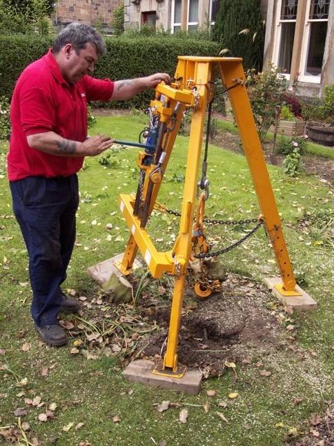

I'm not an M.E. But I remember the tripod hoists we used for rescue at the Fire Department. They had solid legs rather than hollow. I think the issue is loss of strength if the leg gets dented.
This search shows many pictures of existing tripod stump pullers. Some of them may give you ideas.

Lnewqban said:
What's scary about that picture is he's standing two feet away from a cable under ten tons of tension (assuming a ten-ton bottle jack) that's simply wrapped around the top of a stump. If the chain slips off the stump, or the cable somehow breaks free, who knows what ten tons of tension will do?

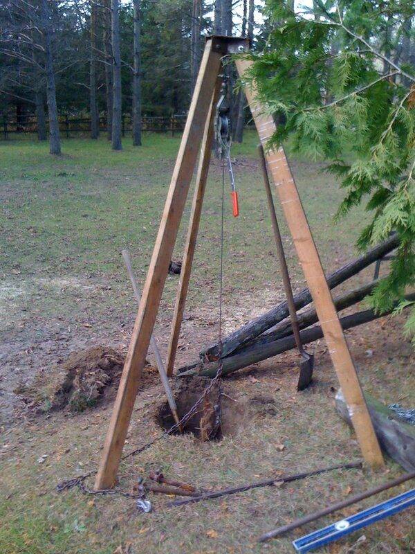

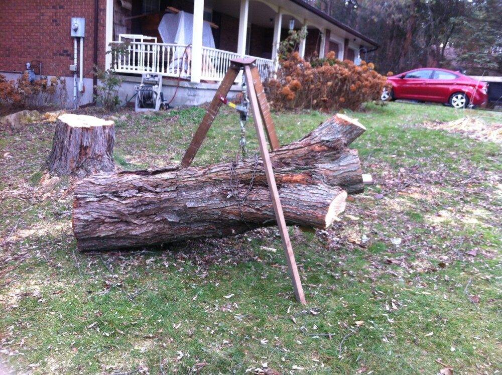

Came across this post and had to show my tripod. Has been successfully loaded to 2,000#+.
Originally designed for pulling posts. Originally used come-a-long, switched to 1500# 12V electric winch as I got older...
Note the winch mounted on a strap of steel so it can hang on the eye bolt, or to chain wrapped around a tree to pull sideways. An eye bolt on the end of the strap acts as a cable guide to keep the winch from trying to twist sideways.
Legs are usually 7' 2x4, switched out to fit the job.
