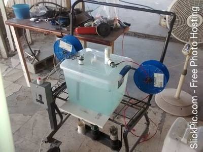

Hi everyone,
Some time ago i made a DIY AC Stick Welder, while i understand the basics of the machine, heat disipation, AC Arc and etc dynamics, I've some doubt i would like to clear before i proced with some modifications.

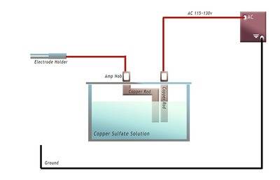

First ill attach its specs and diagram:
It works on simple 110~130v, 60hz at max of 50amps
I plan to modify it for Flux cored wire, but according to some ppl it only works on DC which i think its a "lazy answer", there has to be an equivalent on AC in terms of spark size and heat, I've read all about polarity and related stuff and i still don't get an smart complete answer.
Also id like to know what really happens chemically-wise in the water when mi machine is in use and the byproducts of it all.
Thanks in advance!

TBH, I have no idea how it works. All welders I have seen in my life (not that there were many) were built around a huge transformer unit, which I don't see in the one above. Plus, the only thing copper solution tank does is it adds a resistance to the circuit, I always thought you need as low resistance as possible, as you are working with huge currents.
That being said, I know in some setups tanks with immersible electrodes are used for current control - the deeper the electrode goes, the higher the current that flows (rhyme unintended), so perhaps that's just it? If so, the reaction taking place is mostly copper oxidation/reduction. It won't work that well with DC, as in AC electrodes are dissolved and rebuilt in every cycle, in DC one electrode will be constantly dissolved (the copper will be electrodeposited on the other electrode). You can expect transfer of about 30 grams of copper between electrodes per hour when welding with 50 A.
Yes, as far as i know that transformer unit has 2 functions, one of them is to transform to DC (if needed) and the other one is to absorb heat and electrical feedback to avoid break switches to pop off when the the stick starts to "short circuit" (or so I've heard), which is also the function of the water solution, also, the copper rods work as you say, the closer they are to each other the stronger the amperage, and voltage(not sure about voltage tho), that why i added a Amp Nob, that just rotates on its axis to tune up the amperage according to the rods distance between each other.
As for the copper oxidation/reduction, its true, although i cannot say it gets consumed as fast as 30grams per hour, it goes no where near that, that said, i can assume that at 60hz the polarity switches so fast that non of the rods gets any actual deposit onto each other, the copper rods just get disolved into the water solution I am guessing.
i haven't tried DC on my machine, but i think it won't be necesary for flux core wire if i find out how to tune it up for lower amps and volts, thing is I am still trying to find a solid answer or the AC to DC heat/flame ratio.

No, copper dissolves and gets deposited back - as it does it alternatively on both electrodes (that's what AC is about) the net effect is zero.
30 gph would be the case for the DC.

There are possible byproducts, but if there is no visible gas production the only way charge can leave one electrode and enter the other electrode is through the copper dissolution and deposition. You have a high current, there is no other way it can flow through the solution.
