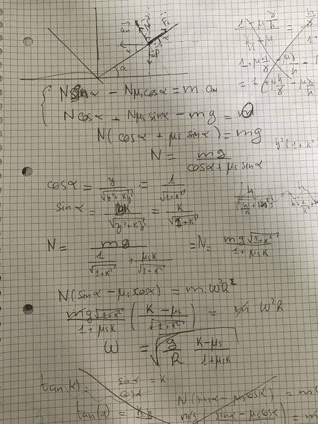

Homer Simpson (mass 123 kg) wants to complete a full lap on a giant hourglass with his motorcycle (mass 158 kg). The cross-section of the hourglass in the zy-plane is given by z = k|y| with k = 0.53, at a height h = 3.5 meters from its center. Knowing that the coefficient of static friction between the motorcycle tires and the surface of the hourglass is μs = 0.6, determine:
(a) the minimum rotational speed ωmin;
(b) the maximum velocity vmax;
(c) the maximum normal force Nmax at the point of contact if the velocity is maximum.
N*sin(α) - N*μs*cos(α) = m*an
N* cos(α) + N*μs*sin(α) -m*g = 0
Hi. I've spent close to 3 hours trying to answer to the 1st question, but everytime I get the same mathematically impossible result ωmin = sqrt(negative number).
Do you see any mistakes? Do you think there's a mistake in the solutions?

Thank you for the reply!
But I don't understand how it would be able to remain parked while being inclined inside a cone?
And supposing that the centripetal acceleration is 0 implies that ##tan(α) = μs##. Which doesn't make sense as it's equal to k. Thank you in advance

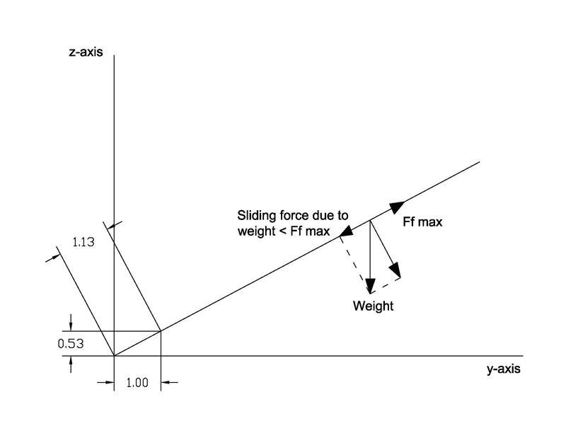

##tan(α) = μs## only applies to the angle at which sliding becomes imminent.
Actually, that is the practical way to determine the value of the coefficient of static friction between two materials.
For smaller angles, the magnitude of static friction, which is nothing else than the Newton's third law reaction to the force trying to induce a slide, is only what it needs to be to keep the static balance.
