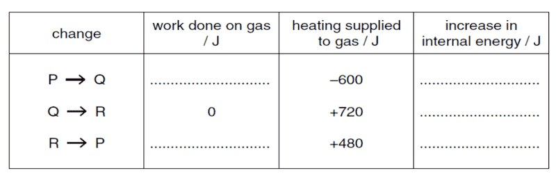

A fixed mass of an ideal gas undergoes a cycle PQRP of changes as shown in the following figure:
Some energy changes during the cycle PQRP are shown in the following figure
Complete the Figure
Find the work done on gas from R to P
I know the work is the are under the curve from R to P
But how to find it
I approximated the curve to a straight line
but I am not sure
Thanks

firstly note that the axis are reversed "X axis is pressure and Y axis is volume"
the problem is in the last row in the table
how to find the work "the area" under the curved path RP
Appluing the second law but for the whole process:
ΔU=W+Q
here ΔU=o for the whole process
Q= -600+720+480 "for the whole process"
now W= 600
so this is the area enclosed by the closed path "because we applied the 2nd law to the whole process"
now adding the are under PQ to this area, we get the area under the curve RP
Looks good, that's the method I was thinking of as well. I'll just add that you want to think about: is work done by the gas, or is work done on the gas? That will affect whether you report a positive or negative value for the problem as given: "Find the work done on gas from R to P"
