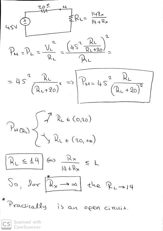

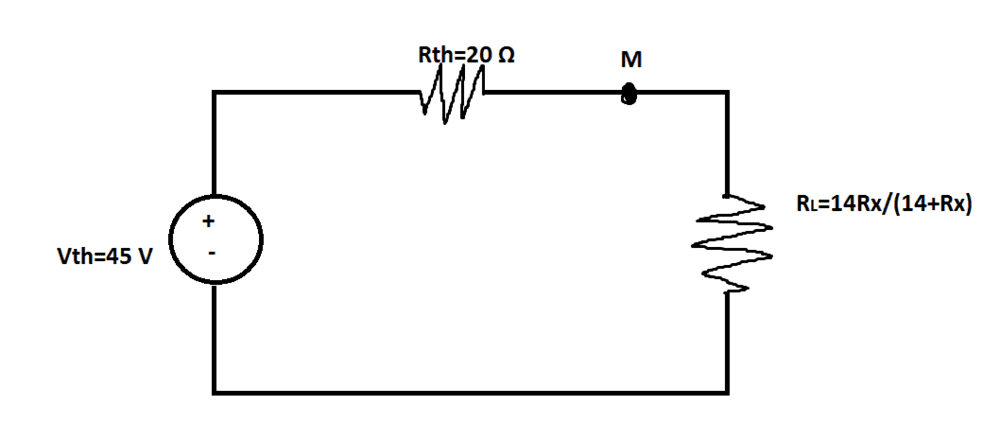

Hi,
after calculations I end up in the circuit below¨ (Thevenin equivalent)

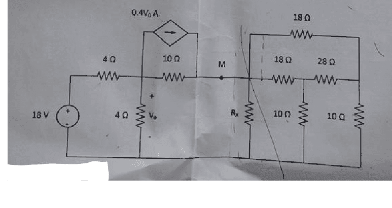

So now I have to say Rth=RL and I will find Rx ?The initial circuit is this:
Thanks
If your working is correct, that's how you solve it, yes. I haven't checked your working.

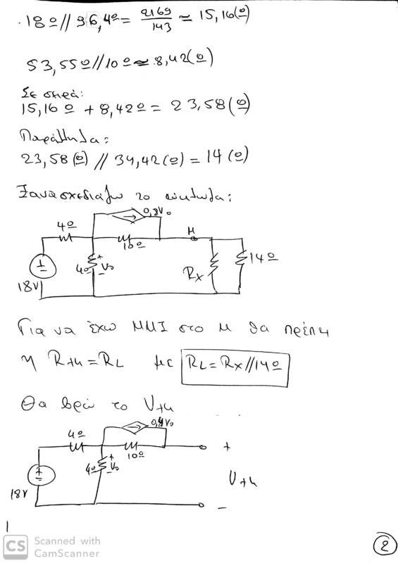

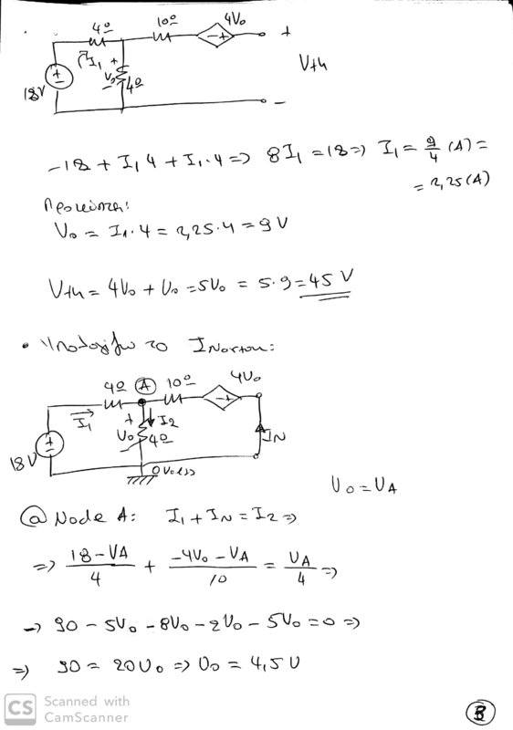

By the way I think this is the way to solve, because we have 2 resistors in parallel:

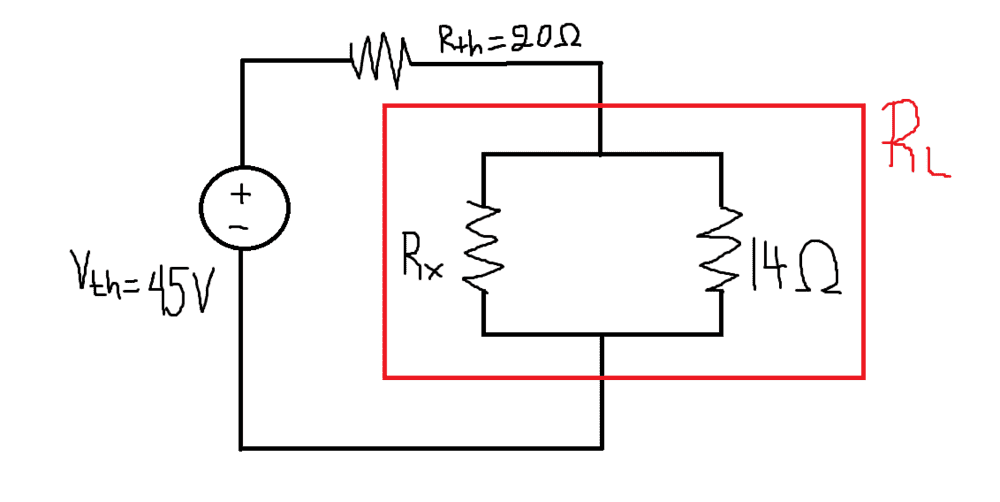

I mean this:
