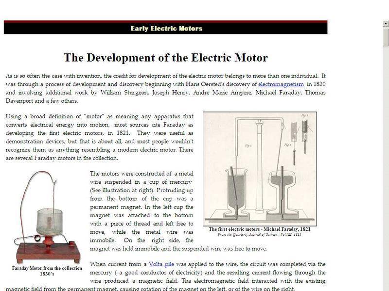

Faraday built a similar motor in 1821. See http://www.sparkmuseum.com/MOTORS.HTM
for a picture of it (see image attached). Faraday used mercury as a contact, and he used a Volta pile instead of an AA battery.
Basically axial and radial magnetic fields interact with radial and axial current in the wire to produce a tangential force (vector cross product, Lorentz equation F = I x B ).
Thanks Bob S,
I now realize that I chose a wrong illustration as well as a wrong title for this thread.

Hey, thanks guys. Both for the drywall screw motor--surely the simplest possible, and the early motors--the brushless DC motors were the best.
I've got to make one when I find a small Neodymium magnet.
I don't have some spare mercury about, so I can't make one of the original brushless DC motors, but using a magnet to preform the task is ingenious. How do these guys come up with these ideas?

I panned about 10 pounds of metallic mercury from abandoned mercury mines in California about 1950, and have given most of it away. I cannot find anyone who wants it any more. I cannot even mail it.
Faraday built his little motor in 1821, about 50 years before Lorentz wrote down his famous equation, and he didn't even get a Nobel Prize for it (Alfred Nobel (1833-1896) was born in Stockholm, Sweden, on October 21, 1833.
