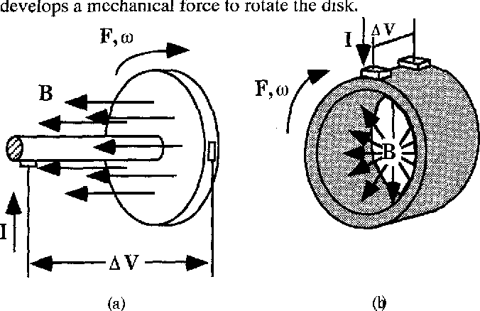

Hi again,
I've found interesting video.
Roller homopolar motor :
Roller Motor
Do you think the motor from 1:08 min Will self rotate in Vacuum/Space
(No other forces : Gravitational or Other type.)
Thank you in advance.

StoyanNikolov said:
TL;DR Summary: Homopolar motor rotation in Vacuum
No. Angular momentum is conserved in vacuum/space too.

Note that the bottom motor may rotate in free space, as it is composed of two pieces that counterrotate: the wire and the battery with attached disk magnets. The wire rotates one way, the battery and magnets the other. The top motor will rotate and align itself with an external magnetic field (by virtue of becoming an electromagnet placed in a magnetic field), but in the absence of an external magnetic field I can't see any rotation happening.

StoyanNikolov said:
Hi again. Found this image (Please see the motor on the right side)
It it relevant ?
Relevant to what? Please elaborate.
