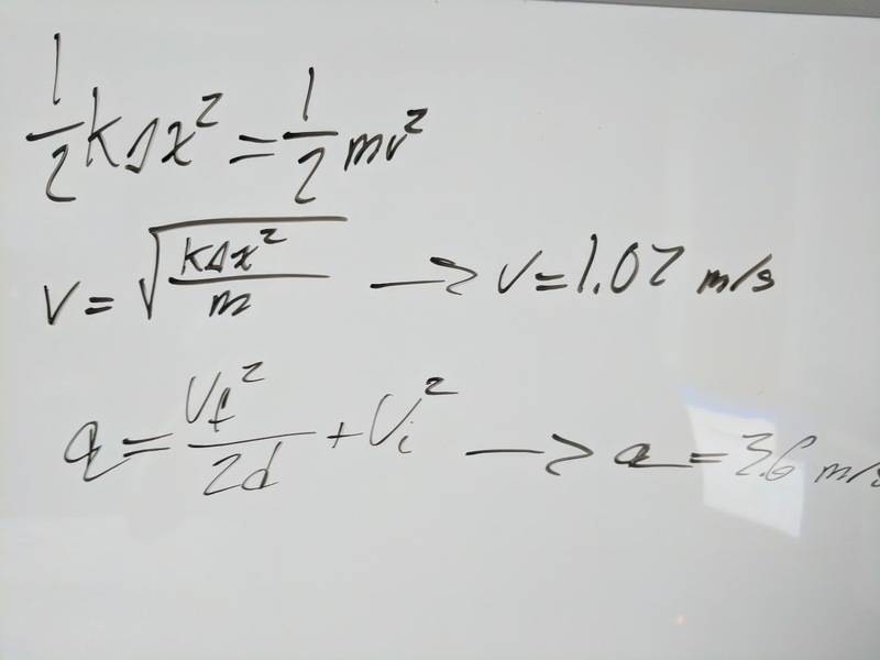

So I got 0.92 J for the energy of the spring when it was stretched and then I was going to make that equal to Ek and then solve for velocity but once I got velocity = 1.07 m/s. Would I then find acceleration by making the 16 cm my displacement and having this velocity as my final velocity?

One problem with that approach is that it ignores gravity. The spring is vertical. As it contracts it does some work against gravity, so not all turns into KE.
A worse problem with it is that, presumably, you intended to use SUVAT equations to deduce the acceleration. But those are only valid for constant acceleration. Since the force of the spring is not constant, the acceleration will not be.

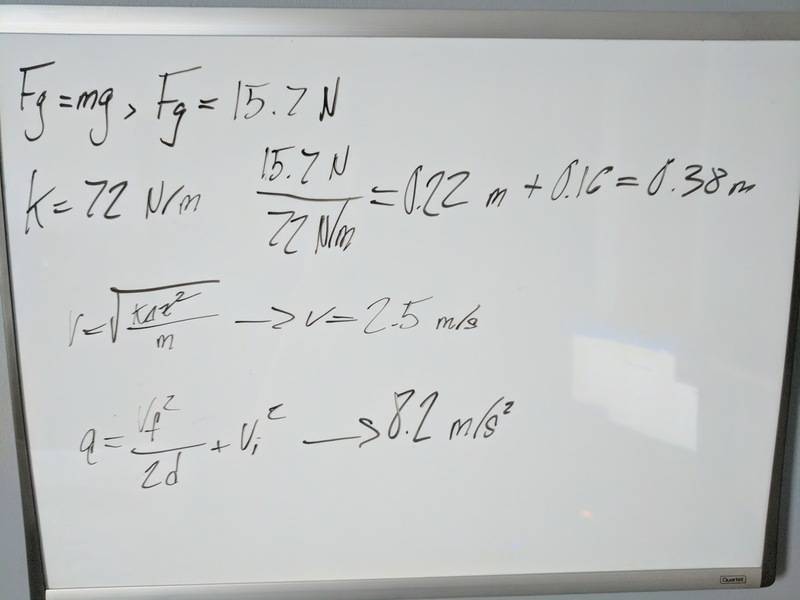

Hey so I asked my physics teacher how to solve this and he said to use my original method of making Ee = Ek to solve for v and then use that to solve for acceleration. So here is that attempt
Although what both you and @haruspex said made sense in how this is incorrect as it ignores gravity but my physics teacher accepted this method. Still, here is my attempt using what you guys said
I think I may have not led you in the right direction, talking about the equilibrium position.
It really is pretty simple. Immediately after letting go, what forces are acting on the mass? The spring (pulling up) and gravity (pulling down). You have a net force (which you can now calculate) and you know the mass, so you can find the value of acceleration.
The one which is stronger, will determine which direction it accelerates in.

Also, back when you write a = Vf2 / (2d) + Vi2. This is from the solution that you and the teacher worked out. Teachers are human, too. They do make mistakes now and then.
Look at the dimensions of each term. I love looking at the dimensions, to see if my workings out make sense.
Vf is Length/time, so square that and get Length2/time2. Now divide by d {length} to get Length/time2. Assuming the 2 is dimensionless, then that is acceleration. But the next term Vi2 is not going to be acceleration, so we cannot add them together.
Likes serunder
Vi is the initial velocity of the mass which means that it would be 0 since it starts from rest which means it can be left out overall. Although I do like the idea of looking at things in dimensions since it makes it easier to figure out what my answer should be so thank you.

Right. Slightly simpler, since what you want is the acceleration, is (tension/mass)-g= 72N/m x 0.16m/1.6kg-9.8m/s27.2-9.8=-2.6m/s2.
That's a worry.
