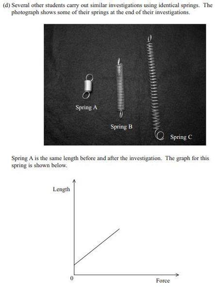

[/B]
I know that spring A shows elastic deformation since it returned to its original shape once the stress removed and spring c shows plastic deformation and has been permanently extended so it won't return to its original shape.
BUT, I'm struggling to complete the graph for spring C especially since they want it to continue from where the line of spring A ends...Any ideas?
ravsterphysics said:
[/B]
What are your ideas on how it looks?
i would have started by drawing a line above the current line since the original length for C is obviously longer than A but after that I'm not sure, but since it has been deformed plastically and permanently I guess I could draw a line curve showing this?
The 3 springs are identical, so the line for spring C must start out superimposed on the line for spring A.
