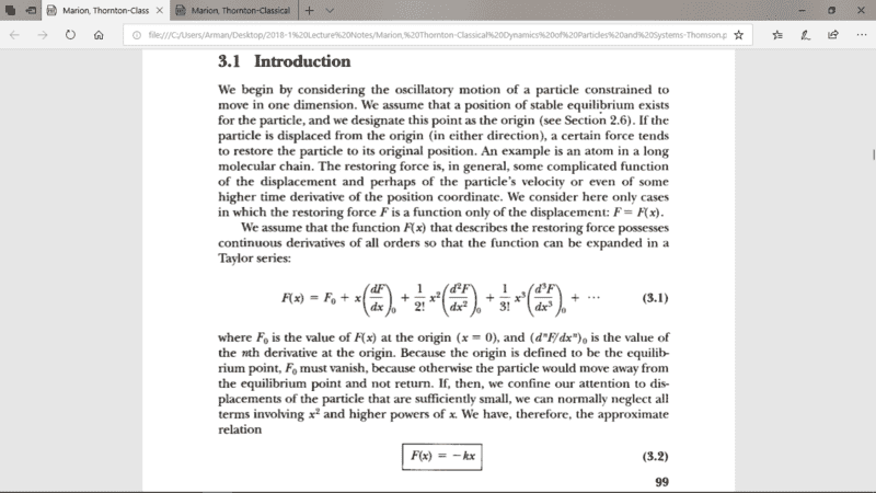

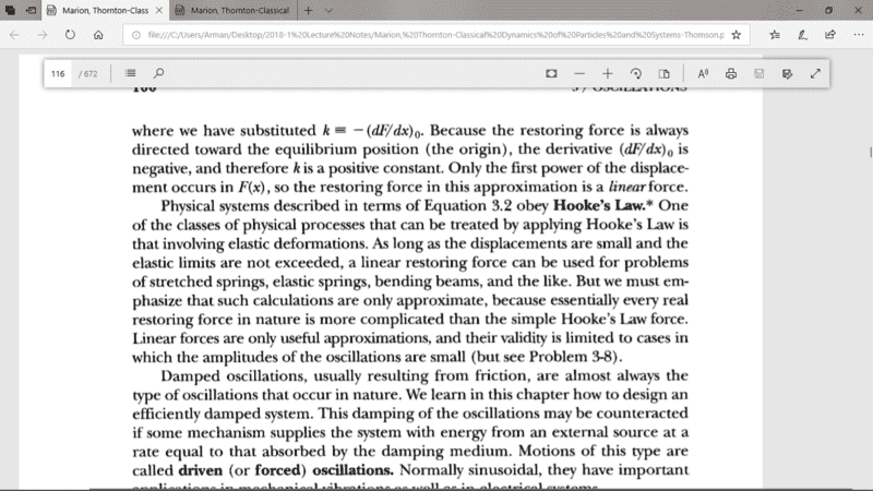

I guees I find why my teacher said like that (Its kind of late I know)

That's a different matter. That's effectively saying that any restoring force exhibits SHM about an equilibrium point, for small enough displacements. That does require small displacements, in general, so that the higher order terms can be neglected.
If the force is linear in the first place, of course, then it applies for larger displacements.

It is why we dislike it when a "reference" is simply a word-of-mouth. It is often unreliable and inaccurate! Just think of the amount of wasted time and effort many of us had to do in just trying to correct you. And this all started in a separate thread with a separate issue!

If you have a graph of ##F## versus ##x##, such that ##F=kx## then the graph is a straight line with a slope of ##k##. Hooke's Law is the assertion that the graph is a straight line. When you measure values of ##F## and ##x## and plot them, you may instead get a curve, in which case we'd say that Hooke's Law is not valid. However, if you zoom in on a small enough piece of that graph, you may approximate it as a straight line, and then you can say that Hooke's Law is valid over that small range of values of ##x##.

Its an approximation yes. Its valid for small x but for large x its approximately true.

It's always an approximation, it's just a question of how much.
